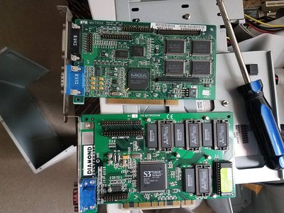

Reply 5370 of 27587, by oeuvre
dat Matrox Mystique

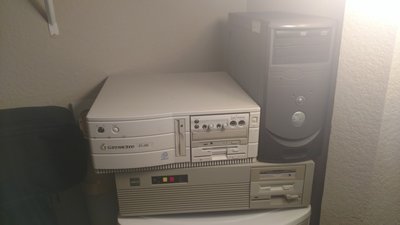

Reply 5372 of 27587, by cyclone3d
I worked on putting my KT7A build together.
It is going into an old Gateway case because none of the other cases I have will fit the power supply and the Thermaltake Big Typhoon cooler due to the CPU socket being right near the edge of the board.
I had to modify the case so a regular sized power supply would fit. The back of the case has a smaller than normal mounting/air outlet area.
