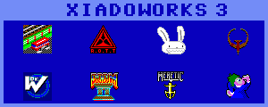

Reply 7067 of 19628, by Mister Xiado
Third set done.
4.11 KiB
616 views
