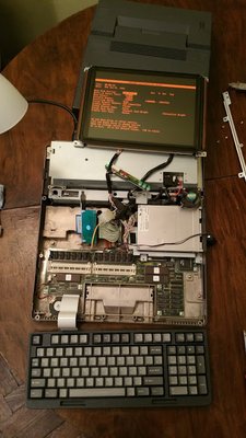

Still struggling with that Toshiba T3200SX. Put a couple hours into it, mostly experimenting with partition size / CF geometry but no luck just yet.

Hook up the CF card to another computer, such as a Desktop, go to the HDD detect settings on the right-hand side of the BIOS screen, and it'll show the corresponding parameters (sectors, heads, compz, etc).

Oh, I see your problem right there.... it has assploded all over your dining table.

I'm using a weird combination of MiniTool Partition Wizard on modern laptop and old Pentium laptop with DOS that already has CF slot and pretty much accepts anything. Repartition using MiniTool, double check with fdisk and format, make sure Pentium boots up and then I put it in Toshiba slot. So far each time only to see - No Drive in BIOS.
The trick is Conner disk has a bit of strange geometry and what data on the internet can be found is different to what BIOS shows and chkdsk says. I am therefore experimenting with various partition sizes and am starting to think I should try another CF card too. Don't want to hijack this thread, but if you think this is interesting and would like to chip in, let me know and I will start a separate thread in hardware section.

Well, I don't have a garage or a mancave where I could dabble in my perverted retro magic, so dining table it is. No wonder my wife gets fussy about it. 😵

It has it's advantages, like motivation to get projects actually finished, and greater need to stay organised.

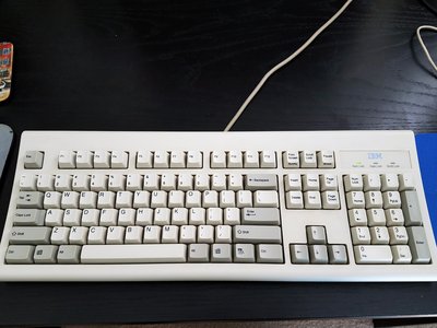

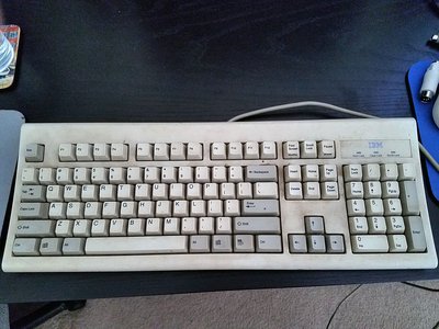

A coworker gave me an IBM KB-8923 keyboard yesterday. Rubber dome but pretty good. It was pretty dirty though. Nothing some water, magic eraser, and isopropyl alcohol couldn't fix.

In that state that either looks like a Voight-Kampff machine or an Esper Photo Analysis machine. Either way, you are now a Blade Runner.
