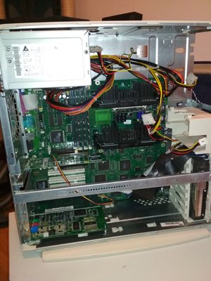

Trying to fit my dual slot1 motherboard in this quite compact Dell case 🤣
Despite the fact it's an ATX case, it has some of the E-ATX holes drilled into the board. I moved the braces to the right locations, drilled a missing hole and made two rubber supports that act like braces.
I had to cut metal parts, bend things... Unfortunately those Dell cases aren't fully standard. The 5" cage doesn't fit anymore. I will have to cut it in half so I can still have a cd-rom drive. 🤣
But heh, it should work in the end 😀

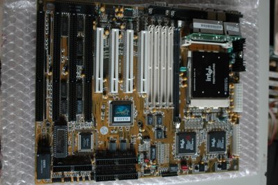

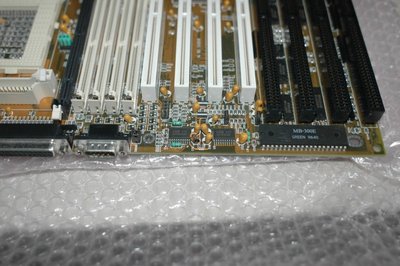

Tried a socket 8 Soyo mainboard (new in a box) and had my second Tantalum cap explosion...
2 boards to recap now... ^.^

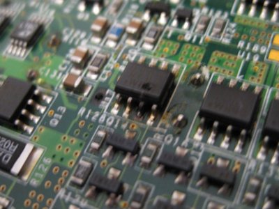

Well, I found out why my Dell Latitude CPi motherboard won't turn on.
108.44 KiB
348 views
Ouch
That pesky little chip on the daughterboard is toast, maybe later I'll see if replacing that part will bring it back to life.
