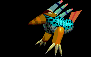

Here. I scanned in the glossy cover of the Tempra Show 2.0 manual. Same exact graphic as the box. 600dpi in 24bit color. It's 30MB so Google drive it is.
https://drive.google.com/open?id=1B4qwHE9xB42 … _mHRJ-Gv35vGWhP
Oh, awesome. I absolutely love this for some reason, it's so surreal & bizarre for a professional application. A couple weird-ass "birds" on a mediterranean-style veranda, against an alien sky, with no relation to the software in the box. The font & the colours are PERFECT too. Thanks for the scan!

Yep, Tempra Show even includes a FLIC file of that bird, which they call a Toucan, as a rotating 3D model. I attached the animation that i converted from FLI to GIF. I know, that looks nothing like a Toucan, but hey, I didn't make this stuff up.

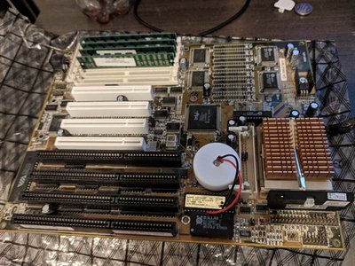

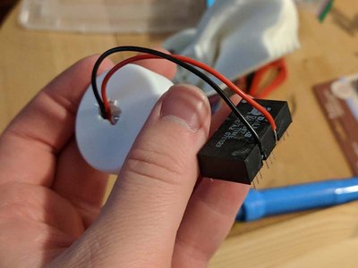

I modded a Dallas RTC. To expose the pins, I used a small hacksaw, which worked very well. It was dead as a doornail- I measured 0.04V across the battery! I know it's not strictly necessary, but I sawed through the top of one of the pins until I read 0V to the bottom. Messy and annoying, but simple enough.
I didn't have a battery holder, so I bought some LED tealights- $2 for 4, with batteries. To my dismay, there's no easily hacked circuit board- the LED pins are the battery terminals. In the end I chose to hack one the easiest and dumbest way. I cut the top of the LED off, and ended up with a really nasty uneven surface. No problem, I'll file it down. Didn't have a file. Sand it down? Couldn't find my sandpaper. I ended up using the concrete outside my front door. Soldered some wires on and the deed was done.
It's probably the hackiest Dallas hack around. Everything reads good, but I probably won't have time to test it in operation until tomorrow. If it's stupid and it works...
