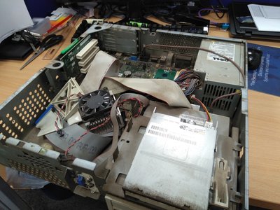

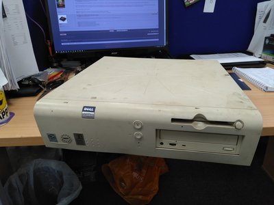

Had an interesting Dell GX110 pentium 3 machine come in at work for data recovery. Been running 24/7 since it was supplied new...there was enough dust inside to knit a jumper with!

Reply 8728 of 27587, by CarlHopkinsUK
appiah4 wrote:
GX110 cool one of my favorite OEM systems. I still need a 3 slot ISA riser for my Low Profile desktop GX110.
Shame it will most likely have to go back to the client to be thown away, would love to restore this one...
246.95 KiB
1511 views
407.11 KiB
1511 views
Pentium iii Coppermine 1Ghz/133fsb installed aswell 😢
