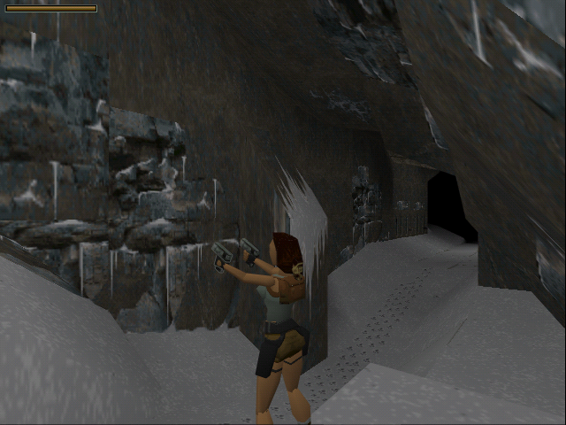

Whenever I play Tomb Raider with the Voodoo Rush patch, which makes the 3D accelerated version playable with 3dfx hardware other than Voodoo 1 hardware, I almost always see a white wireframe outline of the discharge of Lara's guns and her left hand. I am currently using a Voodoo 3, but I remember its presence when I had a Voodoo 5. I cannot remember if it appears using a Voodoo 1 or with the Voodoo 1 patch. The problem should exhibit itself both in the main Voodoo Rush 3dfx Tomb Raider executable and the Unfinished Business executable. Has anyone discovered a method to get rid of it?

Reply 5 of 10, by Spaz
Press F3. It looks like it turns off some kind of anti-aliasing.
I think it look sharper and it solves the problem on my setup. I also have to switch the detail level from Mip Mapping to Normal to get rid of black lines beetween the floor tiles.

Gamecollector wrote:
Well, F3 fixes BLACK borders. But the question was about white ones.
Well, it fixes it on my system. I also got white flickering on the left hand and wireframes around the gunfire. Switching AA off with F3 fixes it.
Maybe you mean F4? That toggles mip mapping off/on.
Reply 8 of 10, by Great Hierophant
Pressing F3 seems to fix it for me at the cost of some anti-aliasing. Thanks Spaz!
Reply 9 of 10, by Great Hierophant
Here is part of the issue (look at the outline around Lara's left handgun) :
I am now of the opinion that it will occur regardless of Voodoo card or patch used.
