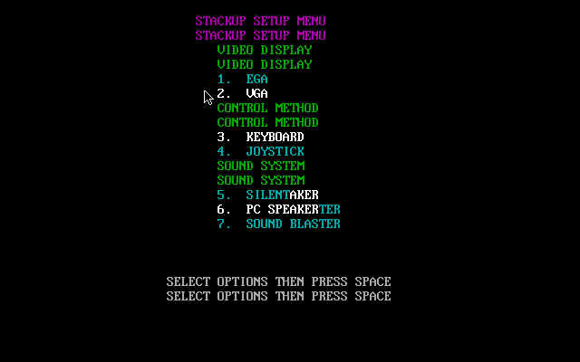

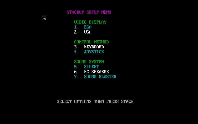

it seemed to happen in textmode concerning int 10 AH 02 and number of rows involved.
I noticed this when trying the game stackup
Before the game starts you have an option menu in textmode. When a key was pressed it became corrupted every time more and more
After some debugging i could backtrace the problem to this in the source coude (Dosbox developers please confirm this as i am no real debugging wiz 😀 )
Seems like there was something wrong with the number of rows that was used
in /src/ints/int10.h
(somewhere around line 96)
#define BIOS_NROWS Bit16u nrows=real_readb(BIOSMEM_SEG,BIOSMEM_NB_ROWS)+1;
And changed it to
#define BIOS_NROWS Bit16u nrows=real_readb(BIOSMEM_SEG,BIOSMEM_NB_ROWS);
That fixed the problem
Added some screens so you would understand it a little better
Ow btw the game still has some other problems when using it together with soundblaster ...
    14.19 KiB
    1099 views
    Uncorrupted options Screen
    18.18 KiB
    1099 views
    Corruption After 1st keypress
