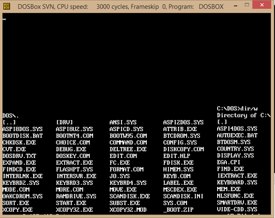

"This enumeration issue in StarCommander does not appear to be linked to a large number of files."
To check it, in 8.3 mode I created a dir and copied ~400 short filenamed files there. Unfortunately, only 31 files are enumerated. This is with LFN flag turned off in DosBox.
Here is a screenshot:
Reply 42 of 104, by Wengier
Hi,
Thanks for testing the LFN patch and report the issue with StarCommander when there are many files present in the directory. I had a quick look at it. While I have not yet found the exact cause of the problem, the issue itself seemed to vanish (at least on my computer) when I added a trivial statement like printf in the source code. Sorry I really don't have much time to investigate in great details at the moment. I have uploaded the version of DOSBox LFN with this workaround applied as an attachment. Please check if it works on your computer. Also note that this version has the patches from the latest DOSBox SVN version (r3876) applied as well.
