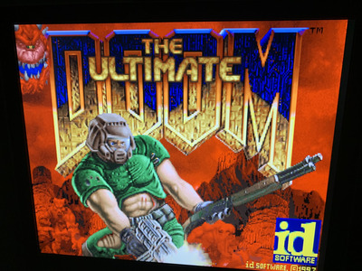

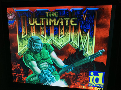

New build with improved 3dfx video cards support:
With LCD monitor in hires (640x400), all previous versions were giving unpleasant "greenish" tint on the image. Difference can be seen on the attached pictures.
In my understanding, all Voodoos starting from Banshee and up to Voodoo5 bios 1.15 should be impacted by this issue. At the moment I can test the improvement only with Voodoo3+LCD, so much appreciate if anyone's interested to try it with other 3dfx card / monitor combinations.
    1.66 MiB
    2470 views
    Voodoo3 + LCD: color issue
    1.46 MiB
    2470 views
    Voodoo3 + LCD: color fixed
