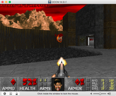

Reply 44 of 216, by Oddbrother
Tried it with FreeDoom on Boxer. Smooth as molasses.
266.9 KiB
2237 views
FreeDoom Phase 1 on MBF on Boxer on Mac

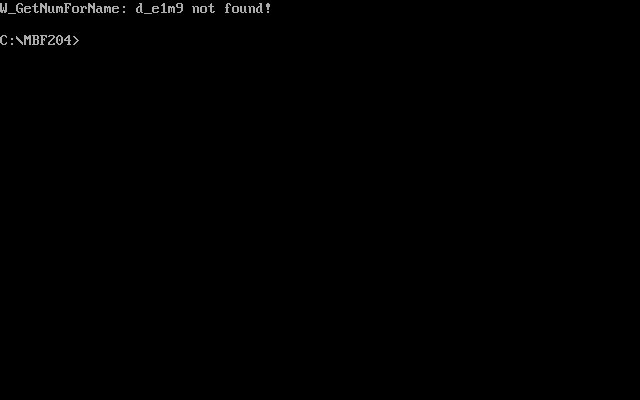

Then tried it with HACX IWAD. Failed on startup.
469 Bytes
2237 views
HACX on MBF on Boxer on Mac
I also tried Chex Quest, but it reported a missing header.

Reply 46 of 216, by MrFlibble
MBF does not recognize HACX.WAD as a valid IWAD because it only contains 21 maps. MBF expects the Doom II IWAD to have at least 30 maps (which is the German release that omits Wolfenstein 3-D levels). Because of how the algorithm of IWAD detection in MBF works, it gets confused and thinks HACX.WAD is a Doom IWAD, hence complaining it can't find E1M9.
That's not all though. HacX v1.2 in its original form will not work with MBF anyway. If you try to load it as a PWAD, it will crash as soon as you try to start the game or the demo playback starts, with a "Segmentation Violation" error message. It turns out that HACX.WAD was compiled according to ZDoom standards, and misses REJECT lumps. This issue is discussed in detail here:
http://www.doomworld.com/vb/source-ports/6121 … nd-prboom-2-02/
I have used ZenNode to rebuild the REJECT lumps, and with this fix HACX.WAD works fine with MBF. Blzut3 says the issue will be addressed with HacX v1.3.
