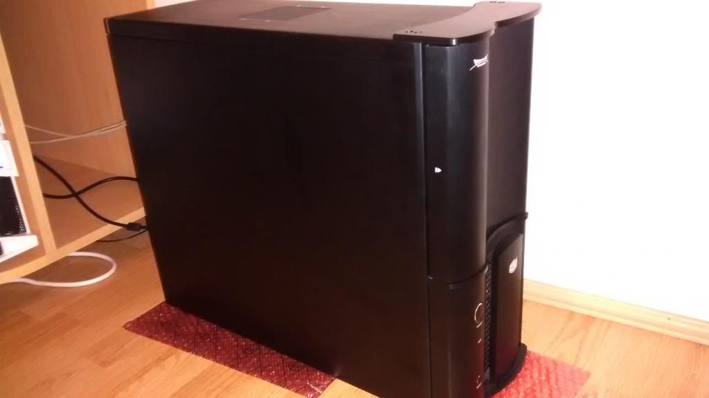

Cooler Master Wave case , obviously a very odd case to house a Pentium build, but its what I have and it looks pretty cool, made of aluminium too.

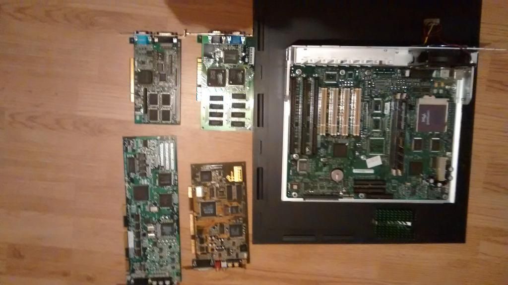

Gateway Motherboard - unusual , but I found this Gateway branded socket 7 board from 1997 , has 512kb of cache and uses the 430TX chipset. Also uses SDRAM which is nice, and is a standard ATX board with USB.
Pentium 133 - Didn't want something too slow to play games like C&C or Duke3D , but didn't want something too fast , I figured this was a good balance.
64Mb SDRAM
Matrox Mystique 220 - It was either this or the Rendition Verite , for the sake of simplicity I chose the Matrox, maybe at a later point I will swap it out but given the Rendition's issues with some games like Doom , Im not too sure.
Diamond Monster 3D - For the couple of early Glide games that hate the later Voodoos.
SB AWE64G and Ensoniq Soundscape for sound
Mitsumi 24X CD RW Drive

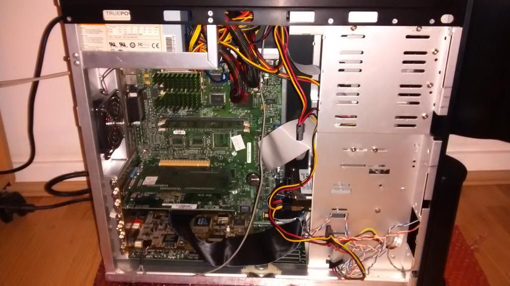

Right now Im busy copying the backed up data I plan to use onto the computer, so I can only show some of the build pictures for now
Forgot the ATA100 card in this pic, but its installed.
The heatsink for the CPU doesn't have a fan , but its a pretty big heatsink , not to mention the passive cooling in this case of 2 front, 1 rear and 1 PSU fans , which sould keep this build at a good temprature
and yes I plan to sort out the cables a bit better once everything is set up properly.
OS and driver/chipset installation went fine, so its just mainly copying over backed up saves and such.

Reply 2 of 7, by meisterister
Nice! That case looks awesome! Do they still sell cases like that, or are they all boring now 😠 ?

I think the case is a Thermaltake Tsunami or something like that..

Thanks everyone, I did make one change to this system, that being the power supply.
The reason being is that the system was randomly shutting down, after which it wouldn't power on until I unplugged the power cord and plugged it in again. I was initially worried that it might be another broken board, but then I decided to swap this Antec PSU for the Enermax 350w PSU I use in my Athlon1400 machine. And the random shutdowns stopped.
On the other hand when I used the Antec in my Athlon 1400 machine, surprise, surprise, it would initially refuse to boot into Windows (kind of just hanged there) and when I pressed the reset button , it just gave me a blank unresponsive screen until I shut the computer off completely , eventually I got it to work (and this has never happened with this machine) , so it may well be the PSU is faulty, may well be the cause for some of the issues when it was running an XP machine. Will probably get a replacement PSU for either machine, probably an Enermax or Seasonic.
Still other than that the P133 machine works great.
Indeed alot of higher end cases now trade solid build quality for things like more airflow or better cable management, while also looking as cheesy as possible .
