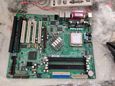

    355.52 KiB
    2612 views

Reply 29 of 47, by gmipf
PARUS, thank you for the information. Soldering a wire is no problem to me. If you can tell me how the shielding is done in detail, I can do it too. The PM function isn't available to me at this forum, can I PM you at old-games.ru or modlabs.net? I have accounts their too. Thank you.
Reply 30 of 47, by gmipf
I have PMd you at the old-games.ru board. For the start I have bought a Pentium 4 660 for 10€ to be able to even start the board, I have no compatbile CPUs at the moment. I think the Pentium will arrive in 3 days. I will buy the X6800 CPU, if its the best, what the board can do. It is a little expensive though. Do you know where to get it cheap?

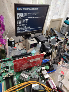

Reply 32 of 47, by gmipf
Thanks for the advises. Then I have to find new RAM modules too. I still wait for the cheap CPU to arrive and to test the board. Of course you are right, this mainboard is much more expensive and rare compared to the CPU. I'm in fact pretty lucky after for long waiting and searching this mainboard, I have got it very cheap. I will order the cpu after validating its functionality.
Reply 35 of 47, by gmipf
It is working! First it wouldn't start, it was a combination of dirty socket pins and wrong RAM. As you said, the board is finicky about RAM, I have then found a 256MB single bank (8x soldered chips) RAM and cleaned the pins and it booted to the bios.
The next step is to buy an X6800, but only at the end of this month. Is it also OK if I send the donation next month?
