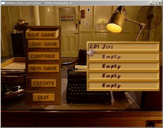

The keyboard doesn´t work at all in this game in DOSBox 0.61 (so it is not possible to save/load or skip video sequences), but otherwise everything seems to work fine. The game was discussed in this thread and eL_PuSHeR mentioned problems with keyboard also in Windows XP. In VPC keyboard works, but sound is stuttering. I´ve tried to change sound card´s IRQ in DOSBox but to no avail. Is there something other I could try to get keyboard working?

Hi, El Pusher. This should enable the keyboard in Dame in DOSBox (tested with 0.61 official version) 😀 :
Install the game, choose a sound card (I picked out Gravis Ultrasound), then delete or rename wintest.exe from the game directory and copy mem.exe in there (where to find it: XP - C:\WINDOWS\system32; Win 98 - c:/windows/command), rename mem.exe to wintest.exe and run the game. Now the keyboard should work fine. With 9000 cycles is speed perfect on my computer with 2.5 GHz processor. There is also a sound patch that can be found at The Patches Scrolls http://www.patches-scrolls.de/ , but the game seems to work fine without it on my comp.

It doesn't work for me. 😠
I get the following error message, both from DOSBox and VDMSound...
Fatal error: Can't spawn WinTest. Code = 1
EDIT: I have reinstalled it and now IT WORKS!!! WOOT!!!!

Reply 8 of 12, by AquariaJade
I have this game and experienced the keyboard problem as well. I have used the mem trick mentioned above...and sure enough...it works. Excellent and thanks...
but...the sound...without the mem fix, is fine, but no keyboard.
with the mem fix...the keyboard works, but sound is pauses in playback every three secs or so for about a second. Tried various cpu cycles adjustments...and does not help much.
