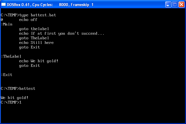

Reply 14 of 15, by Qbix
Rank DOSBox Author
DOSBox Author
it seems to to jump to
vesafound while the name is VESAfound.......
I think dosbox is case sensitive in this case as errorlevel is supported as far as I know.

Reply 15 of 15, by MiniMax
Rank Moderator
Moderator
Uh - oh - the conversion to mixed case was my (failed?) attempt at making the code look nicer. In the original BAT-file it was all lowercase.
Edit: DOSBox 0.61 is not case-sentive:
    18.43 KiB
