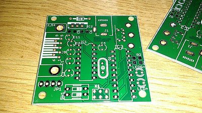

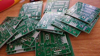

3D Print your own Case:
rs232ps2 v4.2.rar
15.15 KiB
72 downloads
168.62 KiB
1150 views
Green PCB:
237.93 KiB
1150 views
256.3 KiB
1150 views
with proper part assigment print on it.

Reply 187 of 381, by konc
Help the ignorant please!
-What power does it expect? Also the (+) is at the center of the socket?
-(Depending on previous answer of course) Can I take it from the PC's PSU? A molex for example?
Reply 188 of 381, by keropi
-> if you install the 7805 you can feed it something like 9v
-> else you can feed it 5v directly from a molex, no 7805 needed in that case
Reply 189 of 381, by matze79
or use 7805 and feed 12V from Molex.
if you already soldered everything.
Center Pin is GND.

Reply 192 of 381, by konc
Thank you guys, I had left the 7805 as the last component on purpose because of my questions. So I won't solder it and just use the 5V from a molex.
Only remaining thing now is to make sure that the center pin of the socket is ground and the surrounding is voltage.

Reply 196 of 381, by keropi
I have made this quick pic , it shows the 2 pins you can use to power the adapter directly with +5v/gnd (without the 7805 installed) and the psu polarity when the 7805 is installed. Hope it helps.
I really thought the psu polarity was the other way around, luckily there is a protection diode for thoughts like that 🤣 🤣 🤣
Reply 197 of 381, by konc
Thank you very much! If i understand everything correctly, this means that
-If I don't install the 7805 I need to power directly these 2 pins with 5V and NOT the socket?
-I can use the socket (with 12V to the outer of the barrel) only if the 7805 is soldered?
Reply 198 of 381, by keropi
if you are not installing the 7805 then it is better to use the 2 points in the pic, else you would need make some bridges to connect 7805 input to 7805 output. Every combo is possible but it may require some modification in the form of bridges , if you explain exactly how you are thinking of powering the adapter I can tell you what goes where 😀
Reply 199 of 381, by konc
I'm flexible, I haven't soldered the 7805 yet 😀 I wanted to learn about the options though since I'm obviously not knowledgeable enough.
What's certain is that I'll take power from a molex. So since I've soldered the socket already, I guess the easiest thing is to solder the 7805 as well and feed the socket 12V.
