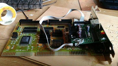

Finally i found some time to complete my multi i/o setup.
Reply 229 of 381, by matze79
