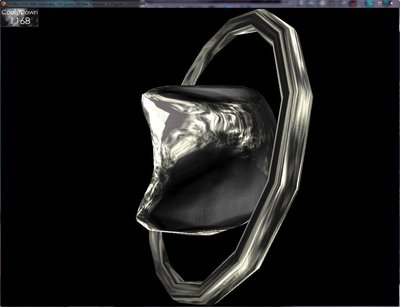

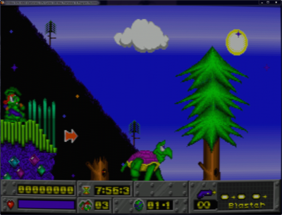

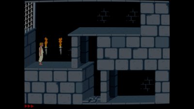

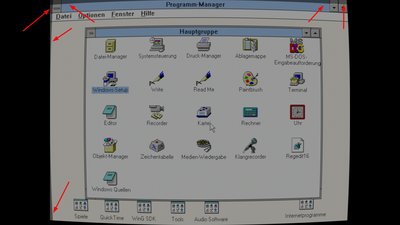

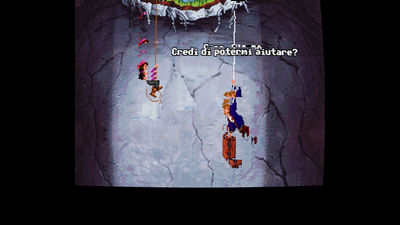

I've looked, because the shader and stretch thing. On the Laptop on my Parents. My Mother (66) is a long fan from the Astronomy Programm PcCosmos. No Problem with the Screen Stretch. All look normal with the schaders. On my Maschine. It is darkened over the arch/bend and not completely black. It is very dimmed. We use the same Config. I think this is a opengl thing.
As Default. I Using a Windows Resolution 1280x1024 with 'crt lottes mod' (look screens). With the other Stretch Problem? Perhaps Dugan or the original author from the shader stuff can still give advice. They can look in the source on my Github Account.I am not very experienced with opengl programming. I try best but i do not want to change too much. Suddenly something does not work. anymore. I use only MingW and Notepad++. 😊 😵
Countdown Demo use 1280x1024 (With vesa_nolfb) (On Default S3, it exists with no memory), Kukoo2 on VGaOnly and Hard Drive 2 on EGA (Look at the screen, all with Aspect = true)
I update this Buld and the source on Github this evening (German Time). Note: you need a new conf to look the changes.

I think the strange stretch problem you saw in the Prince of Persia screenshot is more important right now. Maybe Duncan could help? 😉
Reply 45 of 72, by Diduz
The "stretch" problem with crt-Lottes seems to be related either to GeForce OpenGL Drivers or resolution.
I've just tried the last build on my laptop (1366x768 resolution, AMD Radeon card and drivers) and there's no stretch at all, the shader works like a charm (of course shadow masks look a bit bad within that resolution). I wonder what's going on. 😵

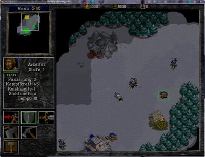

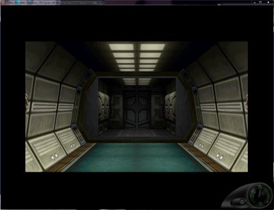

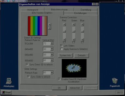

pintglass wrote:
Could you add glide support to your build?
There is a 3DFX Voodoo 'Card' (Source Convertet from Kecko, Daum/ECE SDL1 version to SDL2)
Here Windows 95C build 1212 (No Errors becausei installed it on the VMware and copy the image content to a Dosbox HD Image, for this i added imgmake from the Megabuild )/ After decades, Enemy Zero is finally running with Hardware Acceleration. It has not worked since XP. ..for me 😉
greetings Marty
greetings Marty
