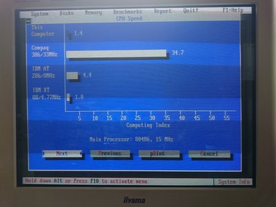

A while a go, I drew a line in the sand with what the slowest PC I was going to build was. Currently, I don't have a 286, nor an 8088 class build. All my builds so far are IA-32 class builds - I mean anything that's considered a 386 or higher. Although, I don't have anything slower that a 486 right now.
However, I still kinda desire an IBM XT class build without actually having to build another box, mainly due to space and whatnot. So I decided to try and slow down my existing systems to approach an XT class CPU - this is way harder than I thought it would be: Ironically, my 486 doesn't have a Turbo Switch, whilst my Pentium systems do - meaning I can slow them down further than my 486. After much trial and error, I benched this:
308.68 KiB
2980 views
I used this version of Norton Sysinfo:
NSI.rar
82.63 KiB
100 downloads
I've managed to slow an AMD k6-III+ down to around an index of 1.4, where 1.0 is an IBM XT 8088 @ 4.77 MHz! That's pretty close to that CPU. The Norton bench doesn't really recognise my K6-III+ CPU, and calls it a 486 @ 15MHz. This is all done in hardware, without using slow down tools like Moslo.
So, I was wondering if anyone can get an IA-32 class CPU close to this or even slower? You can post 286 CPUs too, but I expect them to be really close, and posting an XT itself is obviously cheating, but feel free anyway - have fun slowing your system!

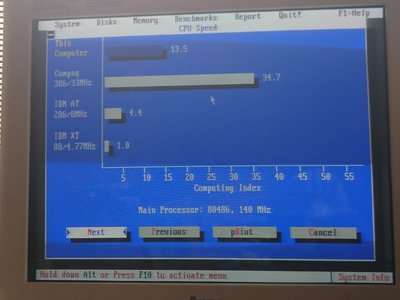

Yes, I have all caches disabled, L1, L2 and L3, and also using the slowest FSB available with a multi of 2x. I get that index score of 1.4 when I have the system in Deturbo mode using the working Turbo Switch. If I keep everything the same, and enable the Turbo Switch, I get an index score of 13.5, and a 486 @ 140MHz, as shown below:
310.71 KiB
2938 views

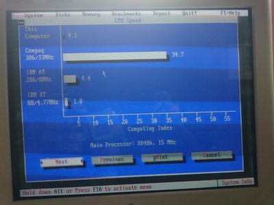

Here's the same system in Deturbo mode with the exact same settings, but this time you can see me using a PS2 mouse, which I am moving rapidly:
278.03 KiB
2938 views
... And you can see this affecting the speed - it drops to an index of 0.1!

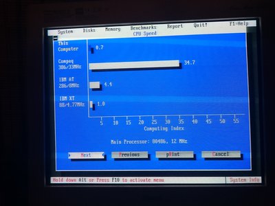

Some more tests - same setup as before, but a different board:
292.99 KiB
2698 views
... So around half the speed of the last record at an Index of 0.7 compared to 1.0 of an IBM XT 8088 @ 4.77MHz. Normalised, we're looking at something around an 8088 @ 3.33 MHz! Quite possibly one of the slowest IBM compatibles around...
It maybe even possible to go slower by modding this board, but not sure why I would need to yet. The aforementioned game, Striker, runs too slow at this speed.

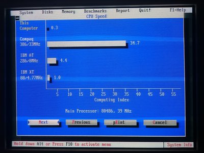

I might have taken this too far; so, for posterity but mainly for shits 'n' giiggles, here are some more results:
361.84 KiB
2599 views
... Still using the previous setup using a K6-III+ and a Socket 7 board, managed to find a slower FSB, so that an Index of 0.3 was achieved compared to 1.0 for an 8088 @ 4.77MHz. Normalised, we're looking at an 8088 @ 1.43MHz...
Tested the game Striker again, and it still runs but loading it takes an eternity, and once loaded, it runs around 3 FPS. Unsurprisingly, completely unplayable, except perhaps using this slowdown as a cheating tool. And explosions in slow motion always look cool.
Gotta admit though, when running DOS, the scanlines updating the screen with text is so slow that looking at the monitor becomes quite mesmerising.

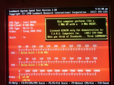

Landmark 2
412.67 KiB
2599 views
Topbench
351.51 KiB
2599 views
I don't know how accurate these benchmarks are at these extreme slow speeds, but the Landmark 2 results are reporting this CPU speed in the KHz range, i.e. below 1MHz.
