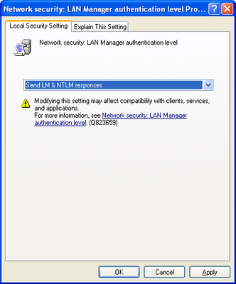

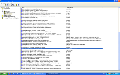

For Windows XP SP3 and later (But not Sp2 and before), in Control Panel -> Administrative Tools -> Local Security Policy, you will need to do the following to allow legacy clients to access shares:
"Network Security: LAN Manager authentication level"
73.11 KiB
1842 views
Change it to this:
20.57 KiB
1842 views
"Send LM & NTLM responses"
Reply 2 of 5, by jd_hupp
Thanks Mockingbird. Vista Home doesn't have a Local Security Policy tool in Control Panel, but in the Registry I changed HKLM\SYSTEM\CurrentControlSet\Control\Lsa\LMCompatibilityLevel=3 –> 0, which is "Send LM & NTLM responses" per https://technet.microsoft.com/en-us/library/j … v=ws.10%29.aspx. Then I rebooted.
Nonetheless it seems to be a necessary-but-insufficient measure. I still get the same error on the DOS client.
