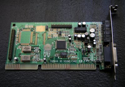

Reply 8 of 11, by squareguy
I am going to test this card when it gets here this week and see if it happens with it, hopefully not.
It is a YMF719-S

Reply 11 of 11, by squareguy
The YMF-719 pictured above caused no problems with same driver, the latest one from Yamaha.
