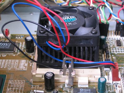

keropi wrote:
Well , it rained here and the temperature dropped quite for now.. guess what , the heatsink isn't even warm now.
This is after you removed and re-ftiited the heatsink? Perhaps that helped? Too much paste isn't good, regardless of brand. You just want a thin layer to replace the the air between the two surfaces. (But surely you know this... I'm just trying to think of Why it was hot.)
My 200mmx at 3.5x66.6 for 233mhz doesn't get hot. Sink is only warm to the touch. Paste is basic white thermal that was bundled with a motherboard.
275.32 KiB
1091 views
Reply 12 of 15, by keropi
Well, a hot heatsink is a good sign, it means it absorbs heat afaik
I don't know fellows, I think I overdid it with silent stuff, the machine is in a bog standard babyAT case that only has the psu for ventilation and right next to the cpu is a riva128 vga, it gets pretty hot too - riva has it's own heatsink/fan too but put all that in a small space , 30degrees environment and low-rpm psu exhaust fan and you get heat built-up really quick apparently...
I'll do some modifications and report back, the heat isn't going anywhere soon so there will lots of chance to test things 🤣
