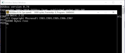

As per his screenshot, I think he's talking about the actual DOSBox graphics window, albeit while using text-mode applications.
And you obviously need to enable a scaler in dosbox.conf to make that larger.

Problem solved as per attached snip. In config file windowresolution=1024x768 (from =original), output=overlay (from =surface) were the only necessary changes. For enhancement scaler=hq3x (from =normal2x) gave marginal improvement. Now appreciate that config file changes affect only the application DOSBox is simulating, which in my case will always be GWBASIC. Think this is so because there has been no change to the Status window.
Thanks for your help SquallStrife and DosFreak, much appreciated.
