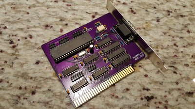

So I finally had a couple of hours and built a thing 😎 still totally untested at this point, but at least completed assembly is a step in the right direction.
I used a male D-Sub 9 connector rather than a female as was called for so that the pin 1 would line up right. I have to make a custom cable for it anyway so I figured it was just as easy to use the female connector on the cable side.
Also, don't mind my "fuse". Other than that I think it looks pretty neat. I know the purple is the default OSH Park thing, but it is a cool aesthetic nonetheless.
    4.5 MiB
    1155 views

I'm hoping that once the prototypes are all built/tested, perhaps these can be sold fabricated rather than as kits. That'd probably mean a switch to SMT parts and a new board layout, but at least it'd e established that the design works by then. I can't solder a board like this to save my life (with my eyes? 🤣... You'd be surprised some of the crap a legally blind guy can accomplish, but soldering ICs isn't one I've mastered yet..)
I for one _like_ the purple. I vote for purple for finished boards--kit or otherwise. 😁 So purrrrrrple...

Well, I finally had some time to install and test the board (after nearly forgetting to flash the Atmega with the firmware), and.... very successful!!! Setting it to IRQ 2, 330h, it just worked... no muss, no fuss. The config program worked as excpeted, and all games I have tested so far have worked exactly as they did with the "MPU-401" interface on my SoundBlaster (which I have removed while testing this). Now, the unfortunate part is I don't think I have any games that actually use the Intelligent mode...
https://soundcloud.com/richard-chute-45223942 … hardmpu-usbmidi
Very well done, ab0tj!
