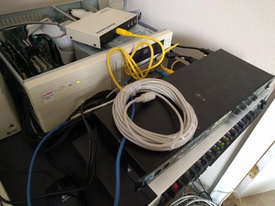

Reply 386 of 608, by ab0tj
Ok, round 2... I dug out my "Roland DG" MPU401 and MIF-IPC-B card. This creates a bit of a mess on my workbench 🤣 Guess what? Monkey Island sounds perfect without slowing the machine down, just like you describe. I'd suspect a problem with HardMPU, but it actually seems to do better than my AWE32 in this regard, and I've yet to have this problem with any other game on my K6 machine... So I'm not sure what to think just yet.

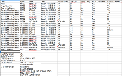

Reply 387 of 608, by aquishix
Great Hierophant wrote:
For the SC-55mkII, the unit needs to be put into MT-32 mode, or it will sound wrong.
This comment inspired me to do a more thorough investigation of the matter.
I have very carefully created 25 separate recordings of my MT-32 and SC-55MkII playing various games via different connectors, etc.
The filenames should be fairly self-explanatory, especially since I based the spreadsheet off of them. To listen to the tracks, go here: http://www.hilbertspace.net/stuff/MT-32/
A fairly detailed spreadsheet is downloadable from the same page. I've attached a screenshot of the spreadsheet for anyone who doesn't want to open the .xls file itself.
The takeaway is that the MT-32 does NOT play Secret of Monkey Island correctly on my system unless it is through either the MIF-IPC-B or a gameport along with SoftMPU. SysEx delaying seems to make little to no difference in any of the configurations I tried. Playing MT32EMUL.MID through my SC-55MkII did bring the output pretty close to the genuine MT-32's output, but even before doing that, it was very clear that it was somewhat correct instead of the garbled mess that it is with the HardMPU or gameport -> MIDI cable (WITHOUT SoftMPU, that is!).
If anyone sees any inconsistencies or other errors in this, please let me know. I spent quite a bit of time on this and I want to get it right.

Reply 389 of 608, by aquishix
Also, some extra info/thoughts after creating the spreadsheet and recordings:
I verified tonight that disabling L1 and L2 cache in my CMOS setup makes both Secret of Monkey Island and Prince of Persia play music correctly to the MT-32 through the HardMPU. Could this mean that the MIF-IPC-B has an unmentioned buffering and rate limiting feature?
Furthermore, I verified that with L1 and L2 cache disabled, Secret of Monkey Island plays its music beautifully through my CT2800's gameport to the MT-32. Nothing else I've tried does, but I've only tried a few things.
With only L2 cache disabled, Abuse's soundtrack seems to be correct, now. (Through the HardMPU. Haven't tried this or anything else with the MIF-IPC-B & MPU-401 after slowing down the PII.)
Tonight has been a joyous and also sad night, because now I'm understanding what's going on a lot better, but I've also concluded that I have to build even more vintage systems because of this. The reason that I had convinced myself that a Pentium II @ 350MHz was going to cover (almost) everything released from 1987 to 1997 was that in my youth, I only had Sound Blaster or SB compatible cards for my audio solutions. The Adlib music on DOS games never seems to screw up or vary at all, really, when playing them on faster or slower machines. (Neither does PCM-based music or CD-audio based music, AFAICT.) The only real problems I can remember encountering while running old DOS games on really fast machines were both graphics related, not sound related. Specifically, the hard-coded velocity of the palette rotation trick employed for water movements in Warcraft, as well as the mouse and keyboard scrolling speeds on both Warcraft and Warcraft II. Similar issues with Alien Legacy, now that I think about it. But these examples are relatively rare in my experience, regardless.
My, my, how owning vintage Roland hardware changes everything.
So in conclusion, I can put this all to rest for myself, because I have a path forward for my vintage gaming project(s). However, it looks like I've exposed a corner case for HardMPU (*especially* because SoftMPU was working correctly, even with the high CPU speed!) that should be explored and corrected. It might even turn out to shed some light on the inner workings of the whole Roland device chain. (MIF-* --> MPU-401 --> MT-32)
It's particularly interesting to me that the MIF-IPC-B prevents timing issues from screwing up the music on the MT-32 with Secret of Monkey Island while the gameport --> MIDI approach with my CT2800 does not. It's almost a logical conclusion that MIF-IPC-B is doing *some* kind of buffering or rate limiting, even if it wasn't designed to prevent problems like what I've experienced with the HardMPU. However, the fact that the SysEx delay feature of the HardMPU did not also correct it is baffling. Makes me want to understand exactly how the various delay techniques work in these different solutions.

No, the MIF-IPC is a simple interface to connect the MPU-401 to the ISA bus. Any "magic" is happening in the MPU itself.
Since this works with my AWE32 and gameport adapter with the system slowed down, that means Monkey Island uses UART mode. UART mode is simple: the bytes that the game writes to the MPU-401 are to be sent to the MIDI device, no further processing happens. UART mode is one place where HardMPU actually doesn't share much code with SoftMPU so I don't think it is a software version issue. The fact that it *does not* work with with the AWE32 without slowing down the system makes me think this is a timing problem. That is to say, the interface is letting MI get ahead of the MIDI stream somehow and bytes are getting lost. I have a few ideas of how this could be happening so I'll dig into the source code when I have some time.
