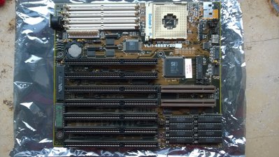

thanks everyone who responded.. i think i have a good grasp on what id like for my ultimate 486!
if anyone can suggest any other boards that have PS2 mouse support . even if the i/o controller is not integrated..
that would be of interest to me. (one such board would be the Asus VL/I-486SVGO .. it seems to have a ps2 connector header but no integrated controller -- and its SIS 471 chipset, see attachment)
is there not any addon ISA cards to provide PS/2 Mouse support on a board that doesnt have it?

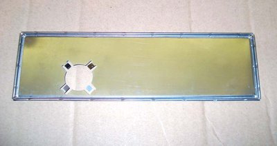

also if anyone knows where to find an AT -> ATX backplate io shield that would be of great use ..

I like to measure out a piece of cardboard as a makeshift backplate in these cases 😀 get some chrome spray paint and no one will ever know the difference!

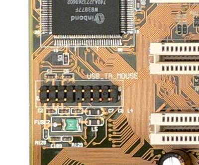

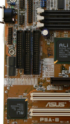

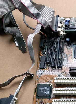

Reply 73 of 130, by chrisNova777
yes i noticed some strange usb headers on boards ive been looking at the last week
one that even said "usbserial" something something and it was not in the standard pin configuration at all
check the attachment - on the motherboard SP97-V i find this "USB IR MOUSE" usb infrared mouse? header?
is this ps2 on the left + a standard usb on the right? merged together? confusing
this same strange header is on the TX97 motherboard Aswell

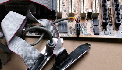

attached i found a pic of the SP97-V with a ps2 header attached to this specific "usb ir mouse" port!!
and its wierd because its not even using half the pins on the header! look at the pic!!
this same type of header ive just seem on the Asus P5A-B motherboard aswell only the header is labelled "usbmir" iguess
that stands for "usb mouse infrared"?

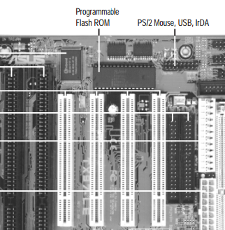

additionally i found the same connector on the motherboard TX97-LE - in its documentation it refers to it as all 3 connections combined..
PS2 Mouse .. USB .. + Infrared! (see attached below)
EUREEKA! http://www.interloper.com/products/product-de … =101688&cat=141
check this post it shows the module that u can use on this type of header to expand it to both USB PS2 connections on the back!!
These are the hard to find ATX Form Card used on PCChips/ECS motherboards around 1999/2000. They give the motherboards that have the header for them two USB ports, an Infrared Port and another PS/2 port. Connects to 18-pin header (2x9) with one blank pin found on motherboard made by Asus, PC Chips, Amptron, Matsonic and others.
more here: http://www.cablesonline.com/usbatxforcar.html

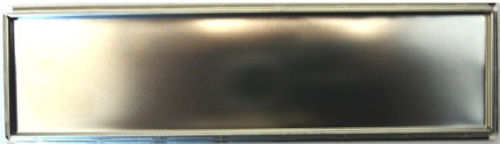

or here is the listing for BLANK backplate (which i couldnt find earlier)
http://www.ebay.com/itm/NEW-SuperMicro-MCP-26 … =item54033d1f42
or the same, but for 10$ cheaper
http://www.ebay.com/itm/Supermicro-MCP-260-00 … %3D360831590210

I've seen these articles. I just can't justify the cost 😵 With shipping, a single IO shield costs USD 25.
