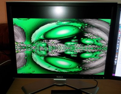

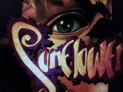

Sunflower's fakemode looks pretty good...

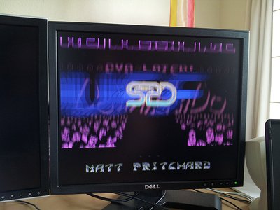

Dowhackado looks great but doesn't pose nice for a photo.

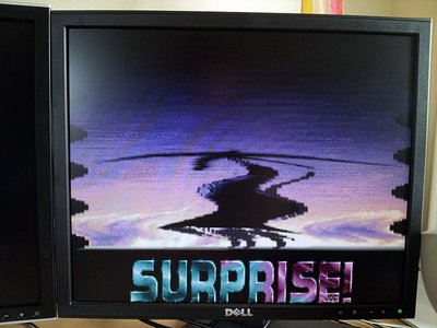

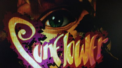

An example of the uneven vertical scaling (200 -> 1024.) Some pixels are 5 lines high & some are 4, with a line of interpolation in between. Without taking a macro photo you don't really notice.

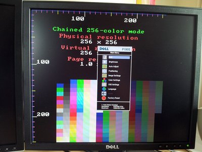

256x256 is interpreted as a line-doubled 500p mode at 57Hz here, instead of the more typical 480p, so less pixels are "lost."

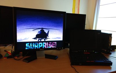

Another Dell model from the same-ish lineup, this time the budget-oriented E177FPb. I'm pretty surprised with how differently all these perform; I was expecting them to behave more-or-less the same, but there's fairly significant changes in the DSP code and processing. Note that this monitor is VGA input ONLY and doesn't have an adjustable height stand, unlike the last two.
Monitor: Dell E177FPb Rev.A00 (Sept. 2006)
Native res: 1280x1024
Scaling: Crude nearest neighbor, causing uneven pixel sizes
Aspect rto: 5x4. All 4:3 modes stretched to full-screen.
Machine: Thinkpad 365ED, MS-DOS 7
Video card: Chips & Technologies 65545 1MB
UniVBE: No
Tested by: xjas
OVERALL COMPATIBILITY RATING: 7.5 / 13
While technically the same score as the 2007FP, the faster mode changes & fact that it doesn't automatically "auto adjust" make it less irritating to use.
Note that the Cubic Player test is still not included, as the video chip in the laptop I used won't switch into 132x43 text mode.

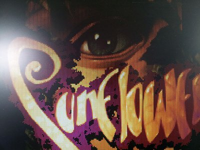

| Sunflower | X | | | Fakemode showed much more pronounced bands |
| | of unevenly scaled pixels compared to |
| | the other Dells. |

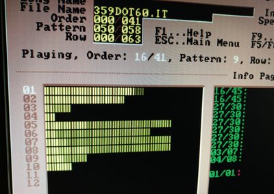

| Impulse Tracker | X | | | Similar to Sunflower, primitive horizontal |
| | scaling made the font uneven. |

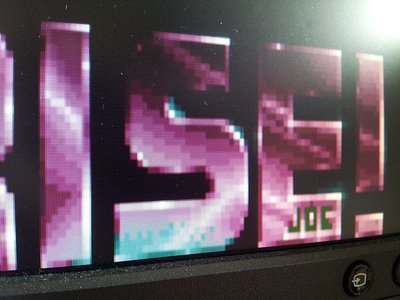

The unsophisticated scaling algorithm manifests as bands of unevenly-sized pixels, as seen here. This affects all these displays, but it seems far more pronounced on this one.

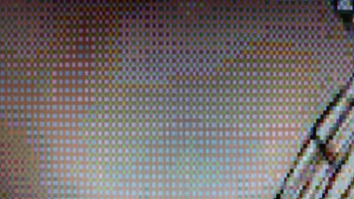

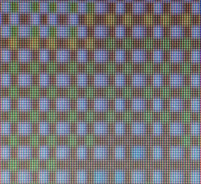

On an image with heavy use of ordered dithering, you can see the effect in both vertical and horizontal. This was 320x200 stretched to 1280x1024. You do notice this sitting at a normal viewing distance, but of course it looks way worse in a macro shot.

I thought it would be interesting to test the Dell 2007FPb rev. A12, since xjas already tested rev. A03. Result difference is very minor though. Still looking for a replacement 2001FP...
Note: Serial numbers ending in "L" have an S-IPS panel. Serial numbers ending in "S" have an S-PVA panel.
Monitor:    Dell 2007FPb rev. A12 (May 2012) - S-IPS panel
Native res: 1600x1200
Scaling: Crisp, with a tiny bit of edge smoothing
Aspect rto: 4:3
Machine: K6-III+ 550Mhz, Asus P5A, MS-DOS 7.1
Video card: NVIDIA RIVA128ZX
UniVBE: No
Tested by: mOBSCENE
OVERALL COMPATIBILITY RATING: 9.5/14 - alright.
Application P F CP Notes
| Ambience | | X | | Out of range. Adjusting the demo with the |
| Luminati | | X | | up & down arrows did not fix this. |
| Timeless (56Hz) | X | | | Worked fine. Image displaced towards the |
|-----------| bottom of the screen. |
| Timeless (60Hz) | X | | | |
| Dowhackado | | | X | Bottom section has glitches, |
|-----------| but this might be intended(?) |
| Kukoo2 | X | | | |
| Copper | | | X | "Wobble" sections blank the screen. |
| Sunflower | X | | | |
| Yo | X | | | (Nice PC speaker beeps.) |
| Impulse Tracker | X | | | Won't play the songs, but display is fine. |
| CubicPlayer 132x43 | X | | | |
| Tweak 256x256 | | | X | Displayed 256x240, bottom 16 lines cut off.|
| Tweak 360x480 | X | | | |
| Tweak 376x564 | | X | | Black screen. No “out of range” error. |
| PAL-on-VGA | | X | | Out of range. |
| NTSC-on-VGA | | X | | Out of range. |
| Other notes: No option to disable auto-adjusting. Also seems to have limited|
| memory to store display settings: when BIOS screen is auto- |
| adjusted, DOS screen does not properly align, and vice versa. |
