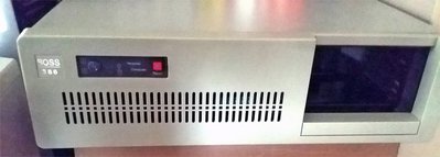

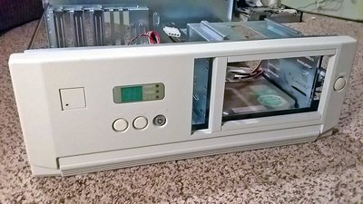

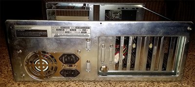

I came across a nice XT motherboard I got as part of a large retro PC haul a few months ago...it originally resided in a large (wide) XT/AT combo, wanna be IBM PC Clone style desktop case that smelled of cigarette smoke.
It is a really cool case though and it even had the "flip-top" style of opening, so after extracting all the nice XT innards from it (XT motherboard, 8 bit MFM Controller, MFM Hard Drive, and FDD Controller), and cleaning it thoroughly, I put it aside in storage to use for another build. The case was cool and all, but was too wide to stack neatly and line up with my other desktop retro PC's (i.e. my 386, 486, PI, PII, and PIII), and more importantly, it did not have a proper front mounted turbo button. Since this XT m/b has a turbo function for 8MHz/4.7MHz operation, I for sure wanted to take advantage of it without having to reach in the back to flick a switch (which it did have originally) to do this.
I know this is very picky of me, but I wanted my only XT build I have ever done to be special and be able to stack properly on my other retro desktop systems as I will be looking to use it a lot. So I put all my XT parts aside until I could find a desktop case that could fit the bill and be worthy of my only XT motherboard I own (except of course for my 8 tandy 1000's I own, but those don't count in my books as standard XT clones of the time).
I thought I would be waiting forever to find just the right case, and all of a sudden, surprisingly, an old XT/AT case turned up at my local electronics recycler. It was lucky that I found it, because I think it was just about ready to be recycled for metal scrap. I went there to pick up some items I won on eBay and there it was sitting in a pile in the back room and I could make out a green LED display and a beige plastic and metal box with my name on it. I right away offered to buy it and luckily the manager there agreed I could. Gave him $10 and I was on my way home carrying an old beige box (with a huge grin on my face) that may as well have been gold for me.
I was further pleased when I found out there were no cracks in the plastic and the metal was as solid as...well...metal. Also, as another small bonus, I measured the case dimensions and I was amazed and very happy to find out it was the same exact dimensions as my other desktop PC cases that I am intending to stack this on.
I proceeded to find a nice 386 m/b in it, but it wasn't too special...certainly not as special as my XT board that I quickly ascertained would fit into this beauty of a case. I removed the 386 parts from the case and went on to transfer all my XT parts into this new found case after I gave it a good cleaning and removed all the stickers and ugly yellow case badge it had on there originally.

This is the case my board originally was found in:
158.88 KiB
1628 views

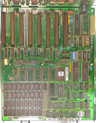

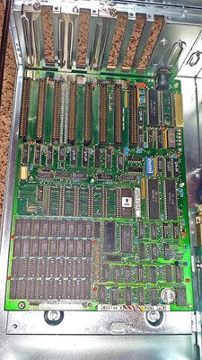

...and this is the 8088 XT motherboard:

The XT motherboard came with 640K RAM and an NEC V20 chip, and an empty socket where the 8087 math coprocessor fits (I hope to get one for this soon...I may have one in one of my Tandy 1000's that I could test).
Overall, the board was in great shape, but kept giving me a "Bad Keyboard" error when I originally tested it. Damn...I almost forgot that I needed an XT compatible keyboard! Well, I went into my stash of old retro gear and found one of my IBM Model M's. I heard that those sometimes work on XT's, so I gave it a try. Well I still got the bad keyboard error. Then I remembered reading somewhere here on Vogons that the keylock circuit sometimes has reverse logic and will unlock the keyboard only if the keylock is locked not unlocked (or I could have just shorted the jumper pin too), but either way, I used a screwdriver to turn the keylock on and voila! the keyboard worked! So whoever it was here on Vogons that mentioned the thing about reverse logic...thanks.

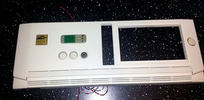

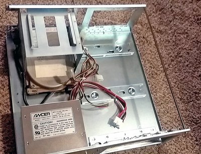

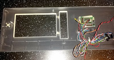

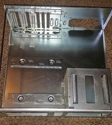

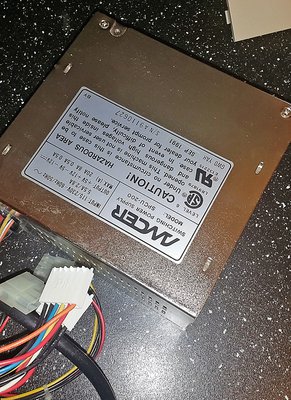

Anyways, as I mentioned I cleaned my 'new' case piece by piece. After all, it wasn't in perfect shape and had some fine scratches and black marks everywhere and it was a bit yellow. I did a bit of retrobright treatment on the front plastic part using my bottle of hair developer and also cleaned everything with a mr. clean magic eraser and soap and water and . I also removed all the stickers from the back of it. I prefer the plain steel look without all the homemade labels and manufacturer label and such (unless it's an OEM system). I still need to find a case badge, but I'm thinking I might just make one. But all in all, it looks pretty good I think.
Moving on, I took apart the power supply and was surprised to not find much dust in there, so I just gave it a little compressed gas treatment, cleaned the chrome metal and moved on to install the P/S back in the case.
550.89 KiB
1625 views
560.58 KiB
1625 views

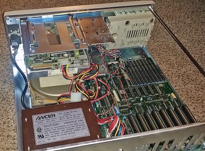

Then I installed the motherboard with plastic and two metal standoffs.
525.72 KiB
1625 views
After, I installed the Seagate ST-238-R MFM hard drive in the bottom of the 3 5.25" bay (the internal one, leaving 2 5.25" bays open) and hooked up all the cables to the 8 bit controller.
I did the same with an old Chinon 5.25" FDD I had and hooked that up to the 8 bit FDD controller.
675.86 KiB
1625 views
I did some initial tests using an old OAK 16-bit VGA card that worked in the 8 bit slot and everything booted fine into DOS 6.0 and the turbo function works great! I tried a couple games already and there is a noticeable slowdown and speedup "on the fly" as I switched the turbo on and off.

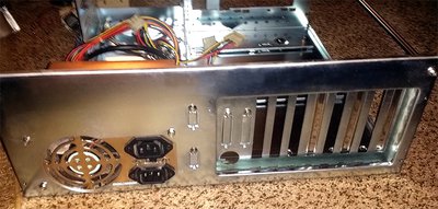

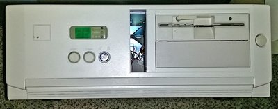

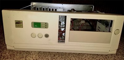

Here are some more pics...(not too interesting)
the back of the case, with and without the stickers and homemade labels...

What are all those empty sockets on the XT motherboard, apart from the copro one? It almost looks like you can plug expansion ROMs directly onto the motherboard? That would be an interesting/handy feature if it were possible!
Those sockets are certainly for some sort of ROMs but I am not sure for what exactly. If anyone can shed some light on this, it would be much appreciated.
Reply 7 of 27, by Malvineous
If my calculations are correct, then 640kB conventional memory will sit between segments 0000 and 9000. Expansion ROMs were designed to sit above this, so that would put the start of this area at A000. Your board has six sockets, which could put them at A000, B000, C000, D000, E000 and F000. The last one has a chip in it, and since the BIOS normally sits at F000, this would appear to make sense.
So in theory if you got a 64kB ROM and stuck it in the first slot, its contents would appear at A000. Interesting!
I wonder whether you could flash DOS onto an EEPROM and put it in there so you could boot the machine entirely from ROM? It looks like you might only have D000 and E000 to play with as the other segments are used by the video card (except for CGA/MDA which doesn't use A000), so I guess it depends on whether you can fit everything DOS needs to boot into 128kB.
