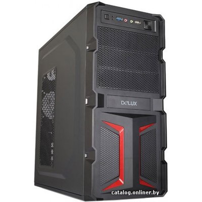

Right now it sits in a Delux MV888. A rather cheap case, but it has room for a 120mm fan in it's side panel to cool the voodoo cards:
105.53 KiB
3904 views
The Antek 300 has the side fan as well, but the PSU is mounted on the bottom, and it might be harder to get the main power cable routed around all the expansion cards:

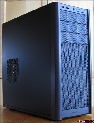

For a case. Try looking for an antec sonata 2 or 3.
Or perhaps a coolermaster praetorian. I would go for cases with these kind of looks.

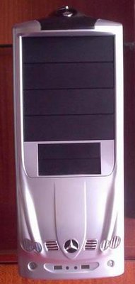

Yeah, stuff like that. Even worse:

Reply 9 of 27, by brostenen
Wow... That is some seriously ugly Benz wannabe case.
I bet the quality is not even half the German standard.
Please just don't get one of those alien cases that are blue,
or red or silver or black. The one with two giant eyes.
They are the absolute worst quality. Thinner plates than Codegen.

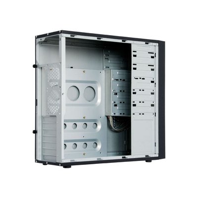

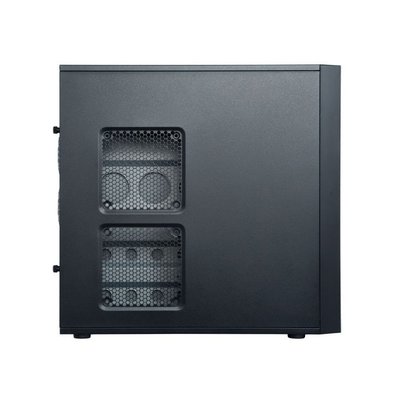

Well I couldn't find the time to post some OC screenshots, but I will do it later today or early tomorow.

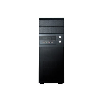

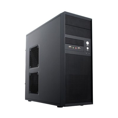

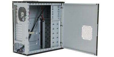

On the other hand, I did find a great cheap case to house the machine - and it fits all my criteria: The Chieftec Mesh Series CQ-01B-OP
71.59 KiB
3504 views
- it's clean looking design
- PSU is on the top
- it has two cutouts on the side for 120mm fans - the bottom most one can be used to actively cool the Voodoo 2 cards (witch get really hot in this system)
- has 3.5" external bay for FDD
- it's cheap- ~24 euro
- thick quality ssec steel and good build quality.

A close second was the Antec VSK-4000B - it fits all the above criteria except it's more expensive then the Chieftec, costing ~40 euro and doesn't have fan slots on the side BUT you CAN fit a fan there. It just won't be as pretty.
http://www.antecindia.co.in/product.php?id=NzA0NDI1
Tell me what you guys think. What case would you use?
