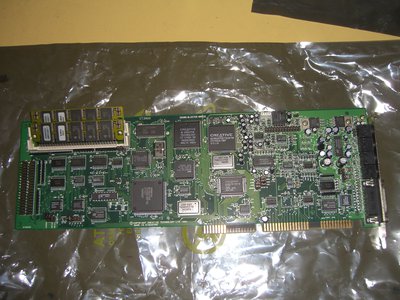

I bought a AWE32 CT3900 on Ebay a week ago, I got the card this friday and I tested the card today.
The issue is that the card dosnt output any sound when using its EMU8000 synth or OPL3 synth, the digital 8bit and 16bit audio part works however. Diagnose.exe thinks everything is working but Synthesized Music and AWE Synthesized Music dosnt produce any sound. I have tested the card in two different systems with the same result, my old CT2760 works but the new CT3900 dosnt. I have not reinstalled any drivers or changed any config files but it shouldnt be needed as both are non PNP AWE32 cards and diagnose thinks everything is fine. I have checked with mixerset that it isnt an issue with output volume or muting. The result is the same in DOS and Windows 95.
Here is a picture of the card. The jumpers seem to be at their default positions. I tried to disable the IDE controller but it diddnt change the situation so I enabled it again.

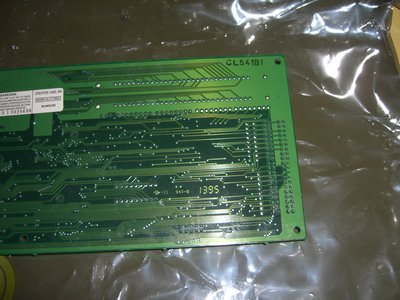

Reply 2 of 39, by Skyscraper
There is plenty of scratches on the back but I can not find any broken traces.
There isnt any static sounds when the EMU8000 or the OPL3 synth is playing, nothing can be heard at all. The volyme level of the digital audio is normal and the audio quality is perfect.
4.21 MiB
1085 views
4.24 MiB
1085 views

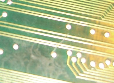

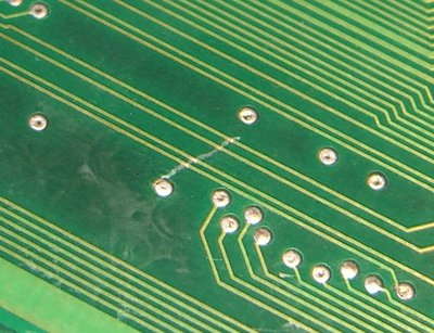

Reply 4 of 39, by Skyscraper
havli wrote:
This looks suspicious. One of these four traces might be cut.
It looks worse than it is in that image, here is one sharp image of the area and one image with the flash reflecting on the traces.
142.79 KiB
1065 views
102.19 KiB
1065 views
