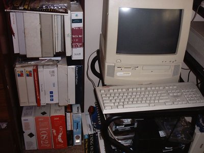

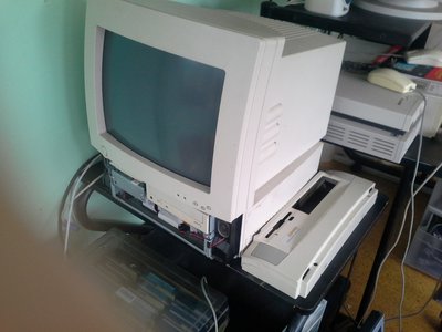

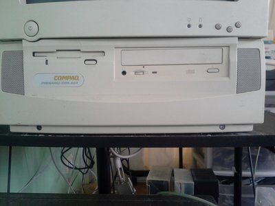

Reply 72 of 93, by Caluser2000
86.34 KiB
2289 views
79.92 KiB
2299 views
Just found a pic of my setup. only had the on board ram when I got it. Maxed that out to 64megs and ran Mandrake 6.1 on a 2.4gig hdd. The limiting factor was the vidio card with only 512k of ram. Ran quite nicely untill the on board ram gave up the ghost.

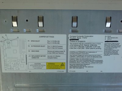

By the way, as anyone ever noticed the WB/WT missing jumpers (P3)? I just bought an evergreen 5x86 133mhz that as a configurable cache mode, WT / WB, but when I set to WB I cannot boot into the OS, totally expected since this motherboard only supports (officialy) the SX2/DX2 cpus. But this missing jumper opens the possibility that after all the motherboard may support WB L1 cache.
Can anyone confirm this?

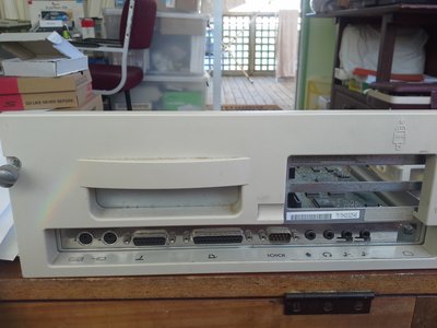

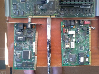

Reply 78 of 93, by Caluser2000

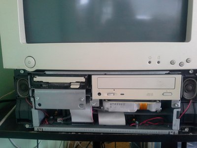

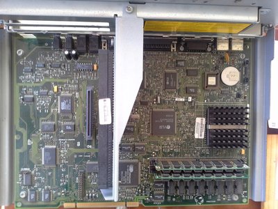

Having look at the CDS524 and giving it a bit of a house clean. Mobo just slips out the back by undoing a couple of screws, after removing any connectors. Removed the modem(which will not be reinstalled and the D-Link 220 nic. Out with a soft artists brush and at quick dusting and give the edge connector a clean. All in all it's in good shape apart from the issues I mentioned previously.
1.63 MiB
2019 views
1.9 MiB
2019 views
1.3 MiB
2019 views
1.38 MiB
2019 views
1.04 MiB
2019 views
These CDS500 series all-in-ones came in various configurations such as having TV/Radio tuners, in built modems and other features. They have ESS ES688F AudioDrive sound built in with Cirrus Logic GD5424-80QC-C video with 512k of vram. The system came out and was sold in early 1995. It is a good set up for those with the lack of room.
Mine has a cd rom reader, forget what speed but replaced the original SB one so I could read RW cds and the standard issue 3.5" drive behind the lower front facia. You can just fit a generic one in by either adapting it to fit behind the facia or making a cut out in the facia to suite the drive. No special connectors just standard ribbon cables and power connectors for the fdd, hdd and CD reader.

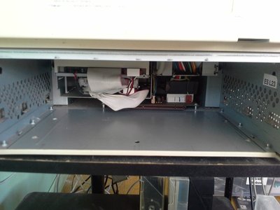

Reply 79 of 93, by Caluser2000
Pulling the front facia is straight forward. Undo the two screws at the bottom then slide the front of the system about an inch and a half (3-4cm)over the edge of a bunch/table the gently pull the facia forward. There are a few clips under the bottom monitor surround. Having the system forward overhanging a bit takes the tension off these and the front facia will come forward and off easier. The fdd, hdd and cdrom caddies are exposed. Just undo the screws holding the caddies in and gently slide them forward to get access to the ribbon and power cables.
1.33 MiB
2008 views
975.56 KiB
2008 views
1.16 MiB
2008 views
1.23 MiB
2008 views
The power cabling is fairy light gauge compared to your normal desktop system and can separate from the plugs if the caddies have been moved quite a bit. It's quite easy to regrimp by removing the plugs cover using small set of pliers as well as the speakers.
