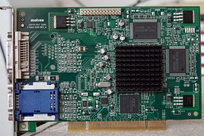

I have an Intel AN430TX based system and was also trying to find a PCI graphics card with DVI output that works well with DOS games.
I started with a Matrox G450 with DVI but on my Samsung 204b that renders 320x200 games (like UFO:Enemy Unknown) at 16:9 and misrenders Gods.

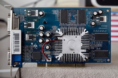

I also tried an XFX FX5200 PCI with DVI and that renders things correctly (as far as I have tested) but the FX5200 runs too hot for my liking in a system like that.

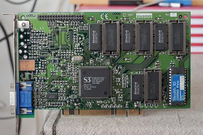

I finally settled on an Diamond Stealth 3D 2000 Pro _without_ DVI.
