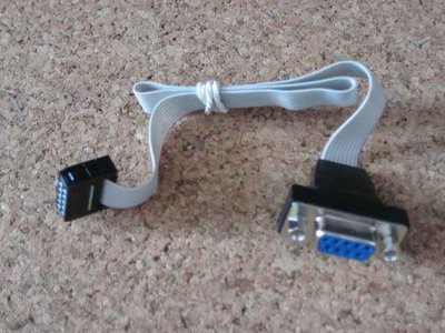

2) A closer look inside of the case revealed there is no way I can move the I/O ports to the holes. As it is, those holes are just too close to the capacitors on the motherboard.

I/O ports - the PS/2 cutout is where it probably would be if the AT mainboard hat one onboard, so I can see why you can't use that one. As for the other ports, I can't imagine that capacitors being that big.

jheronimus wrote:
All COM, LPT, PS/2 connectors seem to be placed on separate boards that are honestly made from tinfoil and flex considerably. I'll have to replace them really soon and I'm wondering — can I place those connectors in the holes that are currently sealed? You can see them above the board slots. Looks like there is a hole for a COM port, a second PS/2 port, an LPT — everything. What kind of hardware do I need for that?
You don't need any hardware. And I don't understand the problem about "having capacitors there". As far as I can see from the picture, you should not have any problems with any normal size capacitors that you can find in a motherboard.
I just need to ask: You are not considering someway to put those connectors with their metal brackets attached, right?
You need to get rid of the metal brackets, and connect the sockets individually to corresponding holes in the case, using their hex nuts, just as they are attached to their metal brackets at the moment.

I actually did not realize I can just dismantle the plates, which is why I asked about additional hardware. I thought you can buy standalone ports without the plate.
As to the capacitors — I'll make sure to post a photo tonight, but there is really no space between the hole for PS/2 and the motherboard.
All in all, this was more about aesthetics, and not really an issue since I already installed all the PCI cards I wanted. I'll just replace the thin bracket later, I think.

Remember that you need to do your own cutout for the PS/2 mouse-port if you want to move it. Its not hard but you need to remove the motherboard to avoid getting metal dust all over it.
Or you could try to find another motherboard with the PS/2 port soldered directly to the board and use the case's prepared cutout.

Yeah, like I said, this PS/2 cutout is made for mainboards with the PS/2 connector already soldered to the mainboard. You can't use it in your case.
Some PS/2 connectors have the mounting holes so far apart they can be fitted into a D-Sub 9 cutout. Seems like yours isn't wide enough though.
