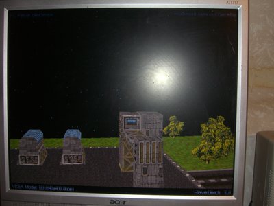

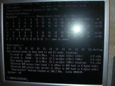

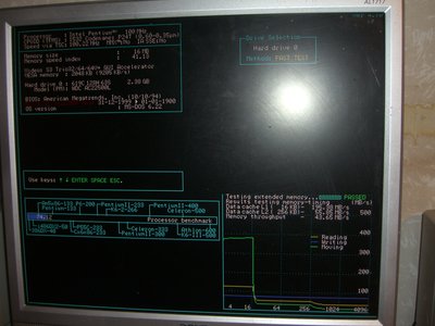

Here are some numbers with a POD @100 running on a PC Chips M921 (UMC chipset, PCI only) with 16MB FPM memory and 256KB cache.
The memory speed in Speedsys and Cachechk is OKish but not great.
4.04 MiB
2072 views
4.07 MiB
2072 views

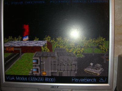

The PCPbench mode100 and VGAmode numbers seem close to what feipoa got.
3.91 MiB
2072 views
4.08 MiB
2072 views
I will see if I can get Quake and Doom installed on this system later.

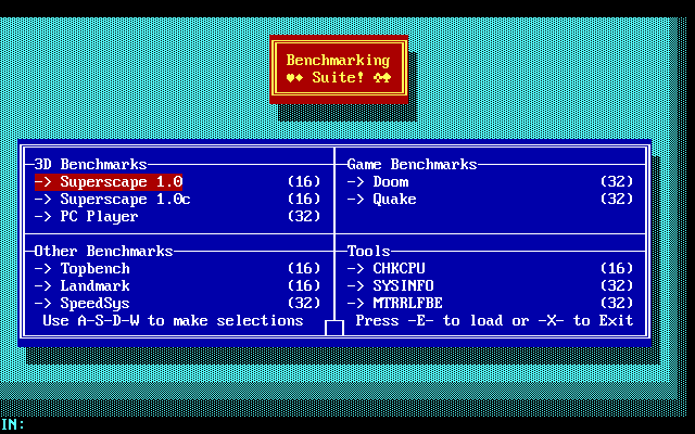

Reply 37 of 44, by HighTreason
Additionally, mine uses the same metric but has a nicer menu (as well as a few silly easter eggs.) because I was bored. Might still cause the screen to jump when making selections though and I currently cannot test.
Currently stored here; https://www.mediafire.com/?bzo4pdyv2ch3lqh
Looks like this;
5.1 KiB
2042 views
Benchmarking Suite
The keys are a bit weird and earlier I did remap the arrows and return, but I figured that would be bad if something crashed as you would then have to "un-map" them manually or reset the machine. Plus some ANSI implementations don't allow remapping. Otherwise it needs a few more tweaks before it gets a proper release, but it is functional now, only really minor tidying up left to do.

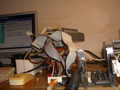

The system diddnt have any means for transfering files as I only had a test drive connected to it but I have now added a CD-ROM drive, a floppy drive and even a horrible mouse.
The new more or less complete test system, Im just going to add a SB16.
4.18 MiB
2006 views

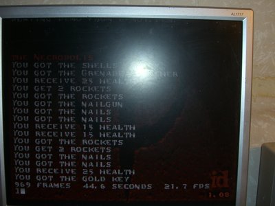

Here is my first Quake result, this is just a quick test for now as I need to do some other non computer related things.
I had to run Quake 1.08 (from one of my bench discs) inside Windows 95 as I got page faults in DOS (Quake 1.01 works fine), this is strangly enough often solved by installing a sound card. Running inside Windows 95 with only 16MB memory without a sound card do probably not produce a better score than running Quake in DOS with sound. The score seems OK for an UMC chipset board with only 256KB cache.
I will try to run Phils full benchmark package in DOS later when I have installed a sound card and created a CD with the benchmarks.
Quake 1.08 demo1 running inside Windows 95, POD@100, PC-Chips M921, S3 Trio64.: 21.7 FPS
