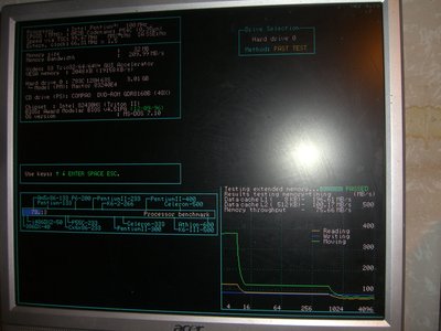

As vetz has covered how a P100 performs with the FX chipset compared to the POD @100 with his Asus VL/I-486SV2GX4 I thought I could add the HX chipset. Im using a S3 Trio64 card with 2MB.
P100, Zida 5DHX rev:1.2 512KB cache, 32MB FPM, S3 Trio64 2MB.
Defaults
3dbench2: 105.5 FPS
PCPbench: VGA 29.7 FPS
Doom: 55.86 FPS
Quake: 25.4 FPS
Tweaked
3dbench2: 105.5 FPS
PCPbench: 30.9 FPS
Doom: 56.24 FPS
Quake: 26.2 FPS
The P100 + tweaked HX system gets beaten by vetz POD @100 + VL/I-486SV2GX when it comes to Doom!
Speedsys
