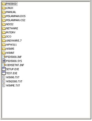

Reply 87 of 98, by PCBONEZ
CU_AMiGA wrote:
Oops. I have Win98se. Realtek don't appear to have drivers for WFW3.11, Win95, Win98
http://www.belkin.com/us/support-article?articleNum=5199
It doesn't list them but guess what happens when you actually download and look in the package.
Ver 1 shown
27.29 KiB
433 views
Ver 1 covers DOS-W2k
Ver 2 covers XP-Win7
Reply 89 of 98, by PCBONEZ
gdjacobs wrote:
OEM disk pack on the Realtek site has that and more 😀
I believe you but that isn't were I looked for the inf to determine if it was a Realtek chip on the card in the first place.
Realtek's package wouldn't be much help if it didn't have a Realtek chip.

CU_AMiGA wrote:
In the meantime, i went to my local charity shop and managed to find this card:
http://www.ebay.co.uk/itm/Belkin-F5D5000-Desk … bQAAOSw3KFWeXOt
I bought it with a voucher so it didnt cost me anything. But can anyone confirm whether this will work in my system (it looks good to me). If so then can anyone point to a reliable place where i can get the drivers for it 😉

Reply 95 of 98, by CU_AMiGA
Good news guys! I finally got round to trying that card out. Installed it, installed the drivers that PCBONEZ linked and the card works just fine. Next I connected that Netgear Universal Wireless thing and Hey Presto I am Playing online Quake 2 death match! Great job guys! 😁
