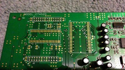

I think you're onto something! The unit I have looks like this one. Though it says CT4520 on the top and has "Creative" written on the big chip and the board, the main chip lacks the AWE logo and "Sound Blaster AWE64" stamp emblazoned in the left corner. Wow, I can't believe I never noticed this! So assuming this is actually an SB16 and not an AWE64, why didn't it get a unique model number from Creative? Did the OEM remove the AWE64 chip but forget to update the board?
Whoa, a castrated CT4520! This card definitely lacks wavetable ROM, 512k of onboard RAM and memory upgrade connector, and does not have an AWE label on main chip, so I think it can work only as plain SB16, not a AWE64. Pretty weird 😵
by the way, can you provide a hires photo of upper left corner of card?
--wbcbz7
Reply 23 of 29, by schadenfreude1
I've attached the image to this post.

Can you check to see whether there is any damage (bent/touching pins) on the large chip on the card? It sounds like you are only getting percussion at very low volumes, and all the other instruments are silent. This could happen if the OPL address or data lines aren't connected correctly - although in a big IC like that one you'd think those same pins would be used for PCM address and data as well, so maybe it's something less easy to fix like static electricity damage from a previous owner handling the card improperly.
Nope, everything looks clean and connected to me.
This sounds crazy, but do you think I might need to set a jumper somewhere on the board to amplify the music signal? I see several available pins, but because the card is a freak and doesn't have a "real" model number, I can't find any information about these ones. I've found jumper information about other Sound Blasters, but the configurations are different. I suppose I could find one that looks similar and try it.
