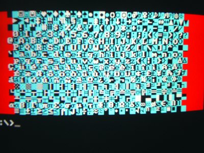

- I've created for you another dump of the CGA ROM, but its content differs significantly from the inital file.
And the size is also different, probably doubled. Hope that's okay.
Thanks, that's interesting actually-- this one seems to have groups of characters mixed from between the different fonts... but not in any consistent way that I can make sense of, heh:
I'm glad it was good for something (I expected worse 😅 ).
The dump was done in an -uhm- special way. I basically convinced the reader to work in a way it wasn't intended (other chip mode, different wiring).
That's also the reason it's twice the size (I didn't expect it to read the data ~8 times, though)..
Plus, the reading was done way sloower than usual this time - instead of seconds, it took several minutes to finish.
Maybe it was a bit too slow? But at least the characters seem to be more clean now.. ^^
VileRancour wrote:
It's also double the size of your previous dump, so I was hoping that at least all the 'pieces' would be there, but in fact the same data seems to be repeated four times (just by eyeballing it... may be even eight with an odd offset).
The strange order/interleave here is mystifying, but having these extra pieces could at least be helpful. I wonder how much of the total font data could be manually reconstructed from this, plus your first dump, plus your composite capture - I might give that a try in my next bout of spare time. 😁
Good luck! 😁 I've got one more screen shot for you. It's taken from a real CGA monitor (my first one ever)!
Quality is far better than the cvbs/composite grab, but the image is also more rounded/curved. 🙁
So I don't know if you can make use of it. At least it shows that the image data is fine so far (which bugs me as well,
because it makes no sense). So what is the card's secret ? Why can it do something all my hardware fails at ?
If anyone has an idea, please tell! I'm honestly happy about any response.
VileRancour wrote:
Once again, I truly appreciate all the effort you're putting into this. If no-one here can tell what's going on with that chip, perhaps the folks at the Vintage Computer Forums may have some insight about why it resists dumping so stubbornly...
Thank's a lot! And I also appreciate your idea! As soon as I reach my limit,
I would be glad to send that chip (or the whole card) to someone with better equipment and more experience.

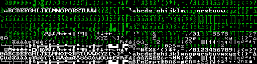

Reply 41 of 76, by VileR
Jo22 wrote:
Thanks! That actually helped tremendously. Took me a while to get to this (was busy moving), but at least font #3 (8x8 w/thick strokes) is fully recovered now:
7.26 KiB
2211 views
I've recovered some more bits and pieces of the other fonts, with the help of your previous dump. As you can see though, there's still a ways to go 😀

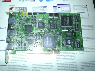

Btw, I've also attached a photo of the composite card for you guys. I heard the Miro products are/were generally quite good in terms of quality.
So this card might be interesting for some of you (haven't tested this one myself yet).
    318.61 KiB
    2082 views
    miroVIDEODC30+ Composite/S-Video I/O card

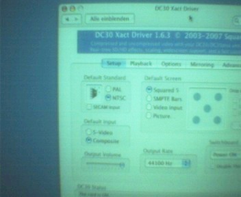

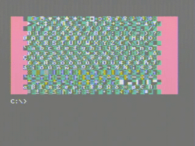

Reply 50 of 76, by Jo22
Quick update - Haven't forgotten this thread, still waiting for the programmer.
And the digitizer card needs some picture editing software to work on the Mac. I'm looking for it..
Edit: I've found and installed the MacOS X driver for the MiroVideo.
Now I need to figure out how to make it work with my copy of Premiere..
Edit2: Premiere 4.0 installed just fine, but doesn't recognize my av card yet.
Perhaps that's because it runs as a classic application on X.
It may take a few day, but I'll find a solution for this.. 😉
Edit3: Phew! I've got the card finally working! I've attached another snapshot for your.
It's still blurry, though. I had to use a video to BMP converter and a lo-fi RCA cable..
This capture was done in sqare-pixel mode, but I've also got a capture in CCIR 601 if necessary.

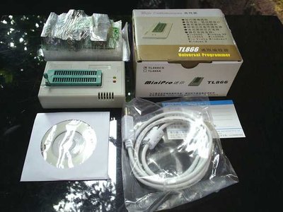

So I've ordered another programmer, a TL866CS. I've choosen this model, because of the positive feedback of other Vogons users.
I already have got the confirmation of payment and it is marked as "shipped". It ships from my country so it should arrive in a few days.
Hopefully it will be able to read that chip. If not, I'll built an adapter with the schematics shown in the link mentioned earlier. 😉
If this still won't work, I'll try to do an RGB capture of that (partial) character set.. Anyway, sorry for the delay and thank you for your patience.
Edit: Good news! The waiting is over, my second order arrived today. 😁
Edit2: Today, I have unboxed my new programmer. It is smaller than my old one, albeit a bit more heavy.
Build quality is fine, too. The software is okay - someone can define pulse delay and voltages.
It was also nice that the seller included a chip puller and some PLCC adapters..
I've attached a small photo for you.
    30.6 KiB
    1824 views
    TL866CS and accessories

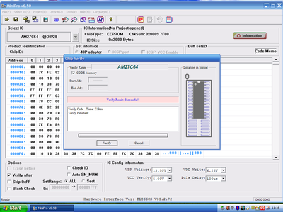

Good News!
The new programmer was able to read that chip. Well, at least it claims it did..
Note that its chip's database doesn't know of the M5L2764K -2, so I choosed a generic CMOS version instead (AMD).
It worked fine after I unchecked the "Check ID" option.
To my relief, the verify check didn't complain and passed without any errors several times.
So I hope that this dump is a bit better than the previous ones, but I still have my doubts.
    58.05 KiB
    1821 views
    Q205_TL866.zip
    4.14 KiB
    67 downloads
    Another dump of the Q205 card with the TL866CS, EPROM (M5L2764K -2) was handled as AM27C64
Reply 55 of 76, by VileR
Actually that's just about perfect. You rock! 😁
6.34 KiB
1797 views
That first font just needs some slight rearrangement. It's 8x14 (probably meant to display at 9x14, Monochrome-like) so those bottom two scanlines of each character are unused, although they actually seem to contain the character's 8-bit index number (red):
7.45 KiB
1797 views
Will definitely convert this for my next update and credit you. Seriously, you're a hero for going through the trouble - I hope you have further uses for that programmer 😀
Hope to finish that update some time next month really, it's been too long...

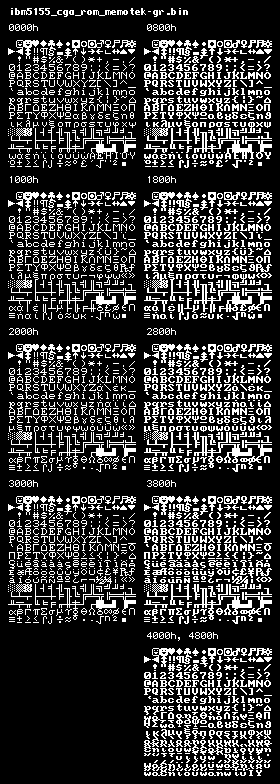

Reply 57 of 76, by keropi
Time to bump this with great news (well... for those than need GR chars that is)
A friend gave me a portable 5155 pc to check out why it does not power on. This was a machine purchased in Greece and thus has the official Greek character rom - designed by Memotek a very popular/important company of the era in Greece.
There is some addon PCB holding a 27C256 eprom - for some reason there are connections to the LPT port - maybe for bank switching? There are 2 ICs on the PCB that are obscured so atm I don't know what they are. One is under glue , the other has had it's markings erased. Is the rom scrambled? No idea either 🤣
Here are some pics:
for some reason there is a soldered extra 9pin output on the cga, it leads to a bracket with a 9pin connector - no idea why the extra output 🤣
I am attaching the ROM dump , really curious to see what's the deal here. 😊
    ibm5155_cga_rom_memotek-gr.rar
    4.85 KiB
    80 downloads
    IBM 5155 Portable CGA Character ROM Memotek Greece
Reply 58 of 76, by VileR
Very cool find! The ROM looks just fine - in fact you have five(!) different Greek encodings in there, and each one comes in 'thin' and 'thick' versions (except the last one which is a 'thick' version repeated twice, heh).

This could probably replace/expand the Greek range I'd already included in the "Plus" (international) version of the IBM CGA charset:
