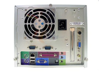

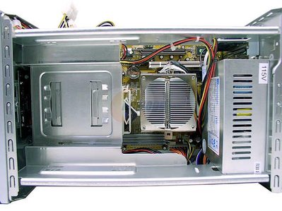

I recently lucked out and found a new old stock Jetway MiniQ cube PC locally for $25 and decided to pick it up. But, while it works perfectly I'd like to pick up a beefier PSU to have for when I begin to do upgrades. However, the current PSU it has is an oddity to me and is of a form factor I've never seen before. I've attached some pictures of the internals and rear so you can get an idea of what it looks like and the mounting points. It's a strange design and the fan sticks out of the rear by about an inch.

I'm not looking to use a high wattage PSU in the 500+ range. Rather, I'd like something around 300-350w to at least have some actual overhead. The current unit is a 230w PFC supply made by Seventeam and model ST-231MZ if that helps anyone. It's almost like a Micro ATX SFX PSU in shape and size but smaller all around.
An ATX conversion is not only impossible due to the form factor (this case is sized like a shuttle PC, which means it's only a bit larger than a Gamecube), but would kill the portability and convenience factor which is why I bought it in the first place.

Looks like a renamed Shuttle mini-pc. Those are proprietary PSU's.
Reply 6 of 8, by Logistics
By the looks of the internals, one suspects a 1U power-supply could be made to mount in the CD-ROM location. Of course that would mean one can't use an internal CD-ROM. But quality 1U power-supplies can be had for very little, often-times--I have an FSP 1U unit capable of 350W that I picked up for less than $15 a couple years back.

I would try to work with the original PSU, recap it if necessary.
I cant find a good picture showing the max current on the rails but I think the 12V rail is 13A = 156W, confirm this by reading the sticker on your PSU.
If your P4 EE is a Socket-478 Gallatin it will probably top out at ~80W, If you use a singe HDD and a single optical drive thats another 10-20W.
Any video card using 50W or less will probably work, especially if the video card takes some of its power from the 3.3V and 5V lines. The X1550 use less than 50W and should work just fine, as long as the PSU is in good condition I would dare to try it.
