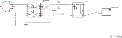

Reply 100 of 292, by McCarthy
Oh, no no, I've recently bought a cheap usb to midi converter also mentioned here. I've soldered an optocoupler on it, removed the resistor R11 and added a 270ohm one. Then I took a pcb and soldered a connector for gnd, Midi out and 5V onto it. I added a hex inverter and another 270 ohm resistor to the 5V line which both do into the cheap usb adapter which also sits on the pcb. The usb cable of the adapter then goes into the Rpi2 with fluidsynth on it.
I've added a brief sketch. Don't expect correct wiring, it's only for visualisation purposes. My sources were: http://www.arvydas.co.uk/2013/07/cheap-usb-mi … ay-be-required/ as well as posts from the vogons forum.
I have no idea what's wrong, because some type of connection is being made, but the wrong notes appear I guess.
Thanks in advance.
Daniel

Reply 113 of 292, by DieKatzchen
So, if I wanted to put this in a box, with a midi in socket and a 16 column display, what do I need? I'm pretty sure I need an optocoupler in there, but that's the extent of my knowledge. I'm using a raspberry pi 3.
[Edit]make that 20 column. Just counted. [/Edit]
Reply 114 of 292, by gdjacobs
I'm currently working on integrating a Pi 3 with the X3M from Serdaco along with breakouts for control switches and an LCD module. I want everything to fit together in roughly the size of a 3.5" drive bay, either internal to a PC or in an external enclosure.
205.19 KiB
2670 views
Reply 115 of 292, by DieKatzchen
I don't know if I'd go that far. If it costs anywhere near the X3M, I might as well buy a real MT-32. I just want to hook up the usb to midi cable I bought and the 20x2 display I already have, maybe with some pushbuttons and a rotary encoder for menus. If the cable has the proper optoisolator in it, do I need another between the uart and the socket, or would that be bad, or would it be an optional safety precaution? I have only vague understanding of the circuit. Somebody mentioned using a hex inverter? what is that for?
Reply 116 of 292, by gdjacobs
Hex inverters are used for driving MIDI outputs and MIDI through ports (two inverters back to back). You can also use Schmitt triggers (74xxx14) for a somewhat cleaner build.
Edit: My apologies to Dr. Otto Schmitt.
