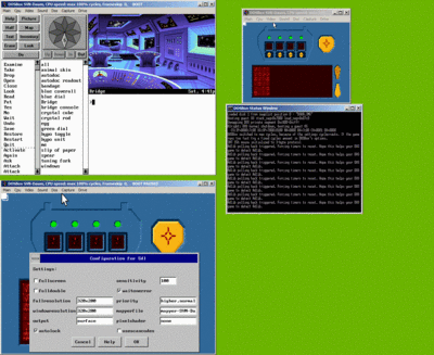

Hi all. I am running an old DOS mode game called "Gateway 2". It is mixed text-mode and mouse driven. Nominally it runs in 640x480. For some inputs, it 'simulates' a space-alien computer screen. When this happens, DOSBOX drops to half dimensions. Attached is the combination of 3 screen grabs, as well as the 5x7 Font Win 7 DOSBOX status window for reference (80 cols x 25 rows).
Top left is the 'normal' game mode. When the user types 'examine console', on a real DOS system he would get a full screen emulation of the space alien computer terminal shown on top right. But under DOSBOX, it is squeezed to the point where the alien symbols are a bit difficult for my human eyes to read.
What is *really* vexing is that if I click on DOSBOX "Video / Resolution / Window / User-Defined", I get exactly the size that I want it to be, (bottom screen grab), but I cannot figure out what Sdl configuration I need to enter in order to keep it that way.

Reply 1 of 6, by PhilsComputerLab
Can you post the config file?
I'd try opengl or openglnb as output, and maybe a scaler setting (2x or 3x).

1) The version of DOSBox you are using is unsupported and broken. Try official DOSBox from http://dosbox.com

1) 0.74 works fine. It may also have been the suggestion from "PhilsComputerLab" in addition to using 0.74; I have not tried 0.74 with my original config. Thanks to both of you!
