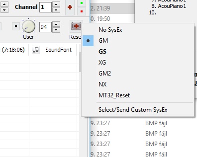

Reply 291 of 1727, by Falcosoft
@ Scali:
There is no 'one fits for all' solution for this problem. In my Midi Player there are several strategies and the choices are offered to the user:
29.77 KiB
5369 views
The Sysex message you have just encountered is a very good solution for most cases since devices that support other midi systems (GS, GM2, XG, NX) also supports the GM System ON SysEx message.
But there are pre-GM devices (e.g. the popular Roland MT-32) and other synths (e.g. first Sound Blaster Live series, some OPL3, just to name a few) that do not react to GM ON SysEx message.
For these devices the best thing to do is to send All Sounds Off, All Notes Off, and Reset All Controllers messages. Besides these my player if the 'No SysEx' option is selected also sends the default Controller, Patch (Program Change 0), Pitch Bend (8192), Channel Aftertouch (0) values to each channel (in case of controllers only the changed values are sent that were modified by the played midi file). According to my experiences this solves the problems with almost all problematic synths:
These are the default controller values I currently use:
    0, 0, 0, 0, 0, 0, 2, 100, 64, 0, 64, 127, 0, 0, 0, 0,
0, 0, 0, 0, 0, 0, 0, 0, 0, 0, 0, 0, 0, 0, 0, 0,
0, 0, 0, 0, 0, 0, 0, 64, 64, 64, 64, 64, 0, 0, 0, 0,
0, 0, 0, 0, 0, 0, 0, 0, 0, 0, 0, 40, 0, 0, 0, 0,
Edit:
If you download FSMP 4.5 from my site you can find in the 'SysEx' folder many reset sysex commands (with .syx extensions) for various systems . These are simple binary files that can be sent directly to devices.
For an overall solution I suggest that you should send the above written defaults to devices and then send reset SysEx message(s). This way if the synth does not support SysEx resets you still have a basic known initial state and if it does it can modify its state according to its internal implementation to the given SysEx reset.

Falcosoft wrote:
@ KainXVIII: As James-F has already pointed out in his SC-VA topic SC-VA's maximum volume is intentionally low. FSMP has nothing […]
@ KainXVIII:
As James-F has already pointed out in his SC-VA topic SC-VA's maximum volume is intentionally low. FSMP has nothing to do with it. But as a fortunate FSMP user you have many possibilities since VST effect plugins (gain/normalizer etc.) are also supported 😀 . I currently use this plugin with SC-VA to get some volume gain:
http://loudmax.blogspot.hu/
Video as I'm using it. But definitely S-YXG50 does not need it...
https://www.youtube.com/watch?v=w8qfXEpifvI&feature=youtu.be
Thanks, works like a charm!
