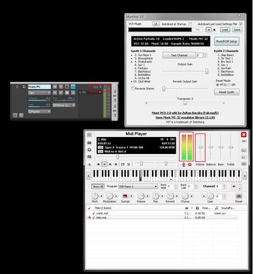

Something like this?
181.32 KiB
1160 views
Website, Facebook, Youtube
VST Midi Driver Midi Mapper

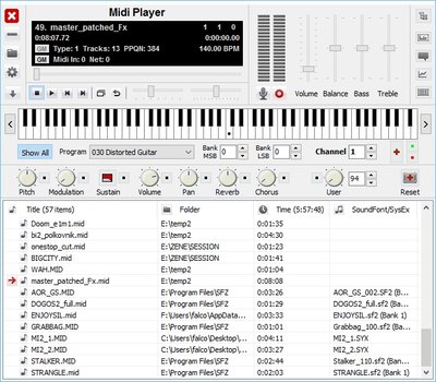

What about a more radical change? Since I now have a right-hand command bar...
41 KiB
1122 views
At first it feels strange, but at the long run it may prove to be more comfortable. I have added an 'Exit' command to the main menu to help the transition while we recalibrate our minds 😀.

Reply 376 of 1727, by James-F
Looks and feels great, much more intuitive for new users.
I really like how the VST menu is first in the list,, much more comfortable (for me) to reach it by mouse.
Although I would put the VST Instrument before Effect 1, simply because how often it is used compared to the Effect slots.
Don't remove the Exit from the main menu, it also quite intuitive to go there.
