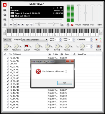

Reply 51 of 1699, by James-F
Bug report.
When I play a corrupted midi file like any of these:
http://www.midiarchive.co.uk/midi/Games/Duke%20Nukem%203D/
Without first clicking stop I "Remove Dead Items", then try to play any other file, there is an Access Violation error which forces me to restart the player.
Reply 52 of 1699, by Falcosoft
Hi,
I have a problem reproducing this error. First, the files you referred do not seem to be corrupted. I have downloaded 4 of them and all plays fine. Of course I can create corrupt/invalid files but these do not trigger this error.
Website, Facebook, Youtube
VST Midi Driver Midi Mapper
Reply 53 of 1699, by James-F
Try to download them "Save Link As", without clicking on them and then clicking "click here to download".
They show ??? for time.
EDIT:
A simpler way is to create a txt file and rename it to mid.
To fix the Access Violation error I can click the "Title (# items)" tab and now I can play a different song.
Reply 54 of 1699, by Falcosoft
EDIT:
As I have written "Of course I can create corrupt/invalid files" actually I have renamed xml files, the problem is I cannot trigger the AV you get. For me the red arrow pointer stays on the invalid file, when I double click it nothing happens. When I click next it simply starts to play the next valid file. Doubleclicking another valid file also starts to play the corresponding valid file.
So my problem is to reproduce the AV. Please, write down exactly what I have to do when invalid files are on the playlist to reproduce the AV.
Thanks.
Reply 55 of 1699, by James-F
Read my first post.
While playing the corrupt file I click "Remove Dead Items" and try to play a different file.
EDIT:
Now I get this error.
60.17 KiB
2628 views
To recreate this, add the corrupt file back to the playlist without restarting the player after the AV.
Now try to "Remove Dead Items" again.
Reply 56 of 1699, by Falcosoft

Reply 57 of 1699, by James-F

Reply 58 of 1699, by Falcosoft
Hi,
1. AV fixed.
2. No auto start after adding item to empty playlist . You have convinced me 😀
