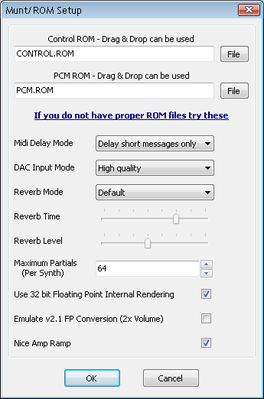

Reply 536 of 1727, by vtheofilis
I use Windows 7 Ultimate 64bit, and tried both versions (64 bit and 32 bit) of MidiPlayer.
OPL3VSTi works, but when I load the MT-32 ROMs for MuntVSTi as in the following image
I get the following message
Reply 538 of 1727, by Falcosoft
Yes, it's definitely a unicode/code page problem. You should put the ROM files into a folder that does not include Greek characters (e.g. C:\ROMS\) and load them from it. I will investigate the problem later.
Edit:
The problem is not in the plugin but in the Munt library. More precisely it is a Visual C++ issue:
https://social.msdn.microsoft.com/Forums/wind … forum=vcgeneral

Reply 539 of 1727, by Roland User
vtheofilis
What will be, if instead easy write in lines Control ROM and Current PCM path , to write easy PCM.ROM and Control.ROM and paste renamed fles to folder ? So wll be work ?
    14.59 KiB
    2120 views
    As this example )
