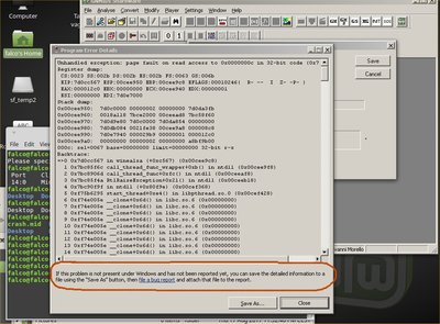

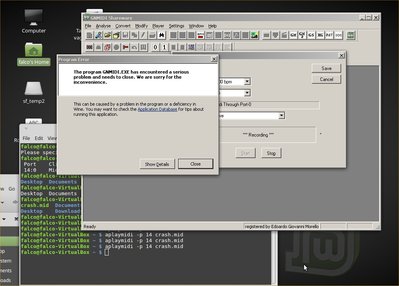

I captured the MIDI data that is sent by ScummVM into a MIDI file. Playing that file directly in Midiplayer doesn't crash it. However, playing it from another player (like the "aplaymidi" CLI tool) using the midi-through port will crash Midiplayer. So it's got nothing to do with ScummVM.
If the midi-through port is 14, like on my system:
$ aplaymidi -l
Port Client name Port name
14:0 Midi Through Midi Through Port-0
24:0 Virtual Raw MIDI 2-0 VirMIDI 2-0
25:0 Virtual Raw MIDI 2-1 VirMIDI 2-1
26:0 Virtual Raw MIDI 2-2 VirMIDI 2-2
27:0 Virtual Raw MIDI 2-3 VirMIDI 2-3
Then playing the midi file with:
aplaymidi -p 14 crash.mid
will crash Midiplayer. I'm attaching the MIDI file. (The forum doesn't accept .mid files, so I had to zip it.)

Reply 765 of 1727, by Falcosoft
Thanks for the test file. I could reproduce the crash with an identical port configuration to yours. Actually I could reproduce the crash with every Windows based Midi software I tried in Wine through Midi Through Port-0. Here's e.g. 32-bit GNMIDI's crash report that is identical to 32-bit Midiplayer's:
159 KiB
3572 views
And on Windows everything is perfect, no crashes at all:
https://youtu.be/9V3-hZIkIYI
It' seems under Wine the port itself crashes and this causes the access violation (because of rather big amount of data within rather small time interval).
So you should report the bug as Wine developers suggest:
234.24 KiB
3572 views
