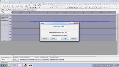

I'm recording super-panned samples for easier looping, but saving sound. I found that these samples were VERY silent. Their silence causes noises.
    204.26 KiB
    1459 views

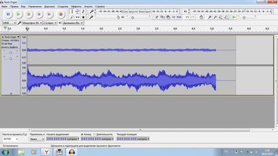

    Same steps as second image. That's what I said earlier. Both samples are on 6th octave and were amplified before taking screenshots.
    201.68 KiB
    1459 views

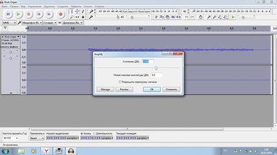

    Look at amplify level and after look at upper right angle.
    235.45 KiB
    1459 views
    Look at upper sample. That's what I'm talking about.
Reply 887 of 1746, by Falcosoft
I see. If you add 12 dB gain to the upper sample by using 'Effect->Amplify' in your Audacity then you should get exactly the same result that SimpleGainVST would do when gain is set to 12 dB. That is the whole signal strengthened by 12 dB together with noise... +24 dB would also strengthen the whole signal further but also the noise proportionally. Increasing gain cannot help decreasing noise if the noise is already in the recording.
The same is true for the real time gain effect of the gain plugin. It cannot decrease noise when the noise is already in the sound rendered by SC-VA .
I cannot explain it more clearly either, so I feel we have to give up...

Third screenshot (Where amplify is 17) shows that sample DON'T have noises. It's problems of recording. Not the synthesizer. And I will not give up until I see that changing the maximum value of the gain range to 24 dB in Simple Gain VST make samples remains with noises.

This above sentence is without any sense. The samples ARE the recording. If the samples do not contain noise then the recording cannot be the problem. The only possible explanation is then that the problem is your audio gear during playback.
Please, do not attach more pictures but audio samples instead.
