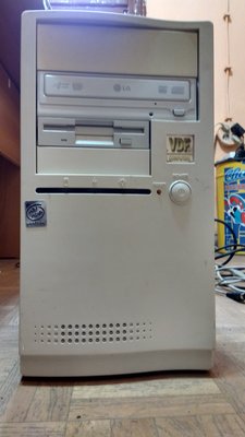

This particular case doesn't look early 90ish, however it hosted a P166 MMX with a dead HDD, so I had to "make some changes" over there 😈 The current HDD is set up as 3 different partitions, C: which contains MS-DOS 6.22, Windows for Workgroups 3.11, Office 4.3 and some other Windows-based software, along with XingMPEG Player, QuickTime, Delphi 1, WinPlay3, WinTune and other useless junk 😜 , D: which contains DOS apps (PCTools 9, benchmarks etc), and E: which contains DOS games. I also made a basic boot menu for XMS/EMS selection. It's noteworthy that it gets 617kb of free conventional memory when booting with XMS, as almost everything (UniVBE, ms mouse driver, OAKCDROM.SYS, MSCDEX, doskey) are successfully loaded high and the Yamaha initialization tool isn't even a TSR, it appears to unload itself after configuring the card! This sound card seems a bit noisy, but SETUPSA.EXE is much better than Creative's loader for the jumperless SB16s, at least regarding memory footprint. The Stealth 64 PCI looked a bit bad as some GPU chip's legs were broken, but a little solder here and there helped it come to life again. While I haven't set up Windows networking yet (no need to atm), mTCP's FTP server has helped me transfer most of what's finally in there and made moving games and drivers easily. It works nicely with Realtek's packet driver. I've been running stuff like MS Space Simulator, Epic Pinball, Terminal Velocity, Microsoft Fury3 on this box all day long 🤣

That case looks almost identical to my own. I tried putting an early socket 370 motherboard in it. Powers on but shows nothing on the screen, screen may be too new...

@zstandig: This one is an AT case, though I have come across several ATX ones with the same design. I even have such a case with a P2B/P-II 450MHz/Voodoo3 AGP setup inside. Hope you resolve your problems and get your 370 up and running!

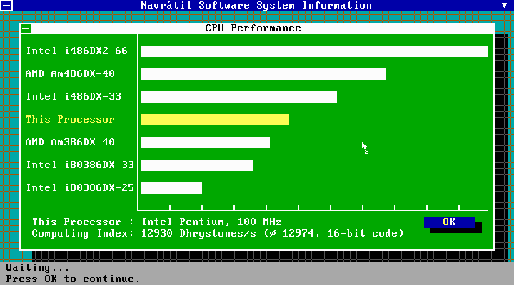

Stojke wrote:
Reply 9 of 12, by clueless1
psychz wrote:
@clueless1: Interesting! Could you please give me more info on the test registers?

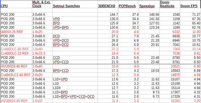

The link in my signature takes you to my thread on testing systems with cache disabled. If you'd like to contribute, the instructions and link to the online spreadsheet to add your results to is in the opening post. But, here's some info specifically on TR:
gerwin's setmul utility thread: SetMul - Multiplier control for VIA C3 / AMD K6+7+8 Mobile / Cyrix 5x86
Specifically:
-Pentium P54C test register "TR12" options. Parameters: BPD - Disable Branch Prediction VPD - Disable V Pipeline L1DX - Disable […]
L1DX - Disable L1 cache exclusively
CCD - Disable L1 code cache
DCD - Disable L1 data cache
PFE - Pentium Features Enable; Resets the above TR12 options to default.
and, some comments from gerwin on TR support:
Re: What's up with all those Setmul switches?

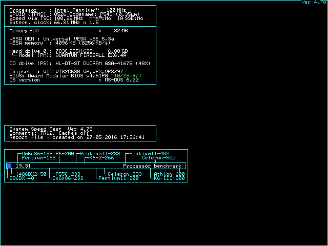

Lastly, some results I came up with using these parameters:

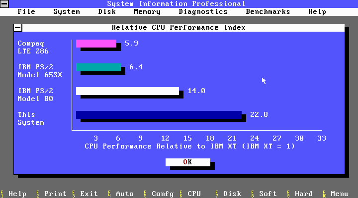

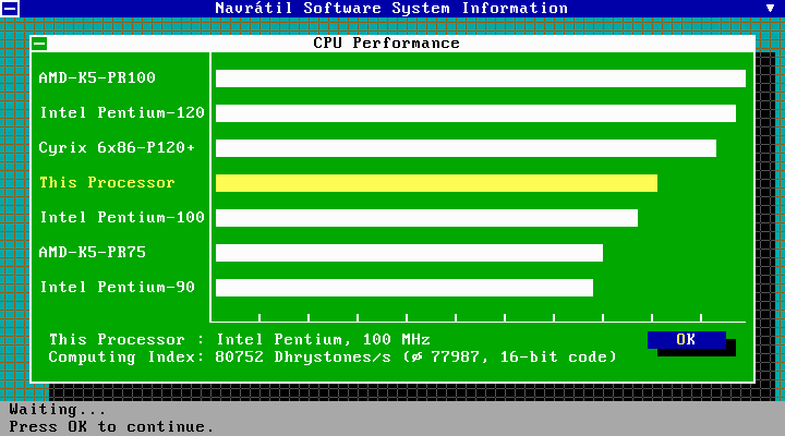

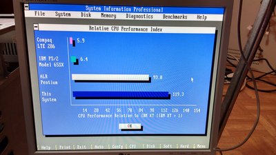

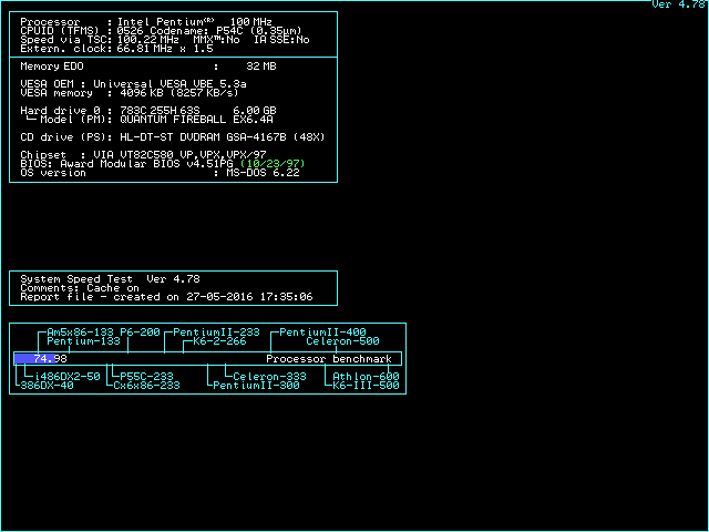

Reply 12 of 12, by psychz
Sorry for being late but due to space constraints I had to put this box away for a while, but it's back up and running! Apparently this CPU does support TR12 commands... More testing and inside pics soon!
    10.99 KiB
    1229 views
