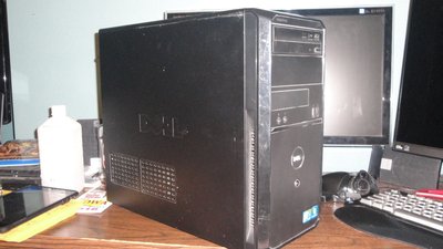

Repurposed business throw-out
169.16 KiB
1242 views
Dell Vostro 230
Dell Vostro 230
ORIGINAL SPECS
Intel Core 2 Duo E7500 (2/2 Core/Thread, 2.93GHz, 3MB L2 Cache)
4GB DDR3-1333 (@1066)
500GB HDD SATA2 (3Gbps)
Windows 7 Pro 64-bit
CURRENT SPECS
Intel Core 2 Quad Q9650 (4/4 Core/Thread, 3.00GHz, 12MB L2 Cache)
8GB DDR3-1600 (@1066)
240GB SanDisk SSD SATA2 (3Gbps)
1TB Western Digital HDD SATA2 (3Gbps)
EVGA Geforce GT1030 PCIe
USB 3.0 4-port PCIe controller card
Windows 10 Pro 64-bit
I haven't replaced the CPU cooler, but I intend to. I'm thinking about a Scythe Byakko 92mm CPU tower-cooler but I'll have to remove the plastic clips and replace them with actual screws, as the Dell MB has a built-in backplate that I cannot remove without risking damage to the MB. I also replaced the stickers on the front with more appropriate ones, like the Core 2 Quad and the Windows 10 Pro stickers. The picture here is an older one before I started refitting this system. It is a cast-out from a local business when the hard drive inside failed. Instead of replacing the hard drive and reinstalling the OS, they opted to purchase an entirely new system with a Haswell i5 and Windows 10 a few years ago. They were going to throw this one away and I salvaged it. It is now my mother's daily PC. I've had to take the fan out of the PSU and clean/lubricate the bearings, and the same for the GPU's cooling fan, but it still works.
UPDATE: Dirty fan was causing GeForce 8400GS graphics card to overheat. I have replaced it with an EVGA GT1030. It's severe overkill for the system, but it's also the cheapest modern graphics card to put in there.

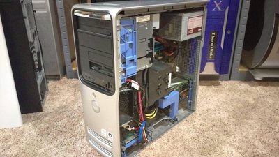

Oh boy do I have a treat (or rather, a whole buffet) for you guys.
It'll take me a bit to get decent pictures of the rest, but lets start with humble beginnings...
957.88 KiB
1211 views
This is my XPS 410. It was one of the first machines I was able to play around with (throwaway from my aunt), and it's still a pretty kickin' system.
I've upgraded pretty much everything in it.
Intel Core 2 Quad Q6700
8GB DDR2-1066
EVGA GeForce 9800 GTX+
Creative Sound Blaster Xi-Fi
320GB HDD
500W Antec PSU
Windows Vista Ultimate

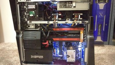

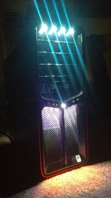

Next up, my Dell XPS 730X (Formerly H2C)
This machine was rescued from a computer shop's e-waste pile. When I got it, it was plastered in "vape nation" stickers and definitely smelled the part.
After much goo-gone and a proper dusting, the machine looked great!
It originally came with the H2Ceramic liquid cooler/chiller, but I had a bad experience with one of those units, so it got pulled immediately.
Unlike my other 730X, which suffered a leak + fried motherboard/CPU, this machine was fully functional.
I added the 5970's for shits + giggles, and 'cause they go great with the case's colors.
918.47 KiB
1208 views
838.09 KiB
1208 views
948.89 KiB
1208 views
This one is mostly original parts, save the GPU, CPU cooler, and boot drives.
Intel Core i7-965 Extreme Edition
6GB DDR3-1066 (3x2GB)
2x ATI Radeon HD 5970 in CrossFire
4x 40GB Intel SSD's in RAID 0
1kW Dell power supply
I really love these machines, and especially their cases. The XPS 730 and 630 machines use ATX motherboards, and the system board connects via USB to allow control of the RGB lighting and fans through the nvidia ESA tools (assuming you don't have an original board).
The 730X used the same motherboard as the Alienware Area-51 ALX, so there are some neat modded BIOSes out there that allow for much newer chips and more RAM.

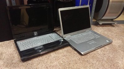

And I'll stop with these two:
964.97 KiB
1207 views
The one on the right doesn't have too much of a story behind it.
One day at the recycling center I work at, it just kinda materialized on a pallet of towers one day. I got it for $20 AS-IS.
It's a Dell XPS M1710. A little bit beat up, but works fine! The video cards are very abundant on EBay, so I upgraded it immediately.
It's a nifty system, and a HECK of a lot cheaper and easier to maintain than it's younger brother.
362.42 KiB
1207 views
Intel Core 2 Duo E7200 2.0GHz
Nvidia GeForce 7950 GTX GO 512MB
4GB DDR2 (BIOS limits to 3.5GB)
120GB ADATA SSD (didn't come with a drive originally), Windows XP Pro SP3 installed.
1920x1200 IPS display

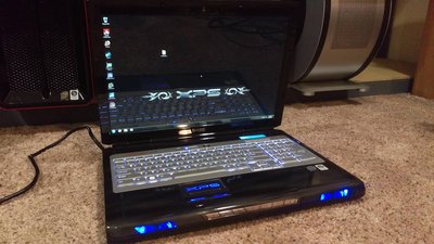

Now for my personal favorite...
955.4 KiB
1207 views
The Dell XPS M1730!
I love this computer. The overdone glossiness of late 2000's is multiplied by a million with this thing.
I got this machine from a nonprofit group that sets up computer labs for other nonprofits. They had this thing lying around, and it wasn't working right, so they let me have it!
The original GPU was a GeForce 8700M, and would not output video. Since these particular cards are known to fail commonly, I resorted to the age-old tried-and-true strategy of "Throw it in a toaster oven and hope that it works..." and well... it did!
I did eventually upgrade the video card, along with everything else. I wanted to max this beast out... and that's exactly what I did.

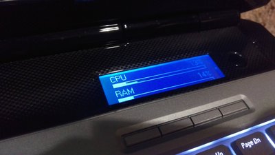

Some neat features of the XPS M1730:
+ Integrated Logitech LCD. Is able to run the same applets that ran on the G15 and G510 lines of keyboard.
+ AGEIA PhysX module from before the nvidia acquisition. The original drivers included tech demos that you could play around with. Pretty neat stuff!
623.41 KiB
1207 views

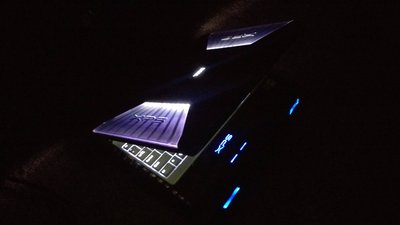

It also looks really cool.
346.83 KiB
1207 views
Now for the specs:
Intel Core 2 Extreme X9000 @ 3GHz
Nvidia GeForce 9800M GTX SLI (2GB)
8GB DDR2 (2x4GB)
80GB Intel SSD
AGEIA PhysX module
Now, for those who know a thing or two about these machines, I did not pay the insane prices commonly seen on EBay for the GPU. It is NOT worth what sellers are asking (often over $300). I was lucky, a seller was liquidating a whole bunch of NoS units, and I nabbed one for $80. At this price, it is very fair.
This machine has been taken apart and rebuilt and upgraded sooooooo many times now. I would like to find an original blu-ray drive just for the sake of "because why not?" but those aren't very easy to come by.
Anyways, hope you guys enjoyed these. Ive got some other XPS machines (M1530, M1640, 8100, etc) but nothing nearly as interesting.

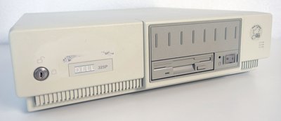

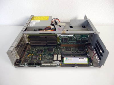

No longer in my possession, but the photos are mine:
493.45 KiB
542 views
1.12 MiB
542 views
At primary school I played around with a similar one but with an i386DX-33 (Dell 333P).
