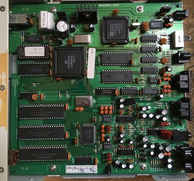

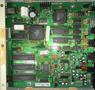

Reply 11 of 11, by asp_id
Sorry for necroposting =) I managed to put my hands on one of these units. It's not in working state for now, but I'm working on it =)
Here's the Guts (2 photos — with and without flashlight):
